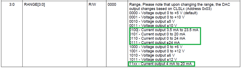

Additional to the traditional voltage mode, this DAC can source current. It has a number of ranges that can be controlled:
In this exercise I'm setting the mode to 0101: 0 - 20 mA.
