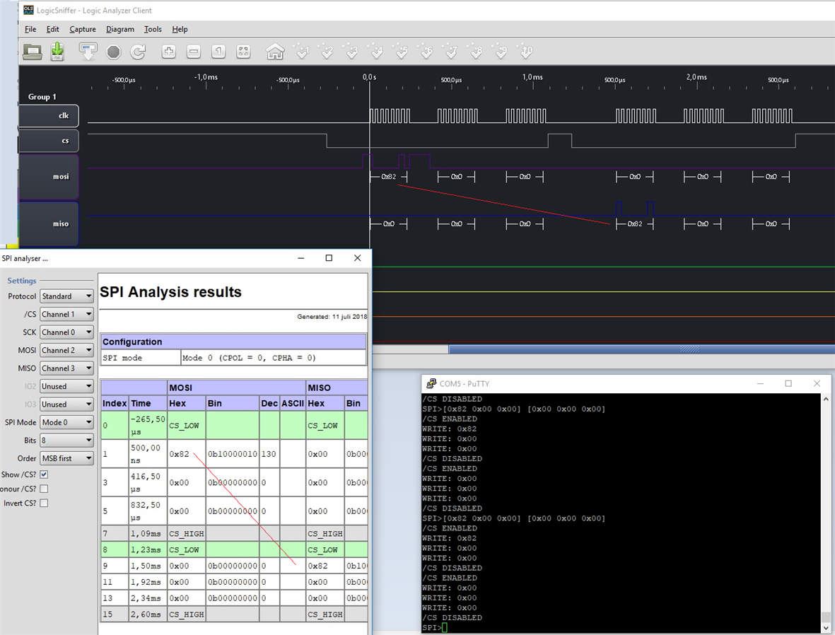

I'm using a Bus Pirate to generate the SPI traffic. My logic analyser is a Papilio Pro FPGA dev board.
As you can see, everything is bodged together somewhat. But as a lab setup it will do.
The Bus Pirate's 4 SPI pins are connected to the SPI lines of the EVM.
The AUX pin drives the ^RESET.
The analog VPU input reads the ^ALARM signal.
You'll see the Bus Pirate's SPI commands later. But let's review the reset and alarm functions.
The reset signal is connected to AUX.
On the pirate, you can reset the DAC by pulling the reset low for a moment.
Here's the command:
To check the status of the alarm pin, execute this:
First SPI Communication
The Bus Pirate needs to be set up correctly for the DAC.
The speed isn't important because the DAC accepts from slow to very fast. I've selected a speed that's easy to capture on the logic analyser.
First I do a soft reset of the DAC.
The register is 0x01, and the 16 bit data command for a reset is 0x0001
Then I do a read of register 0x02. Why register 2? Just random. I want to check if I can send a command and get data back.
To read a register, you have to set the first bit of the address to 1.
0x02 = 0000 0010 => 1000 0010 = 0x82.
So to read the register 2, I have to send address 0x82, and then 16 bits of random data. The next 24 SPI clock pulses will return the address again, and the value of the register 0x02:
The second train of 3 * 8 bits is to generate the clock pulses that allow the DAC to reply.
I could also have used the command [r:3]. That also generates 24 clocks and returns the data on MISO to the console.
The [ ] pairs generate the chip select signals. According to the spec, the CS has to bump between the command and read. That's why the data is split in two blocks ([0x82 0x00 0x00] [0x00 0x00 0x00]).
Here's the traffic on the logic analyser:
Here's the same example, but I use the Bus Pirate's Read command to generate the 24 read pulses. The advantage is that you actually see the returned data on the console:
I know it's all still a bit fuzzy, but I learn as I go. In perspective of the difficulties I had to go through to get this far, the blog looks structured image.

    Jan Cumps over 8 years ago
    It's not easy ... There's two way communication between my controller and the DAC, but no meaningful conversation.
    I first tried to set all registers as I think they should be set, but can't get the DAC to output a voltage or current.
    Then I tried the debug sequence. The DAC has a toggle bit. You set a user bit in one register. That toggles another user bit in another register. You can read that back.
    That doesn't work with my current setup.
    I'll try a new setup, using a microcontroller that I know well instead of the Bus Pirate as SPI master.
    I'll have to write a small SPI firmware program but that should be doable. Hang on ...
