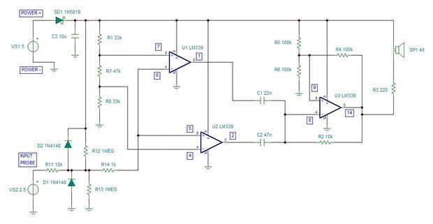

Here's the circuit diagram
The parts represented by triangles are comparators. Operation of a comparator is quite simple, the two inputs are compared and the output driven depending on which is higher than the other. This part that I've chosen is a quad comparator - that just means that there are four of them in the package and they share the power connections. The LM339 is very low cost and is available in a DIP package, so it's nice to experiment with. One thing you need to know is that I've drawn the circuit using the TI-TINA simulator that's available from TI and that package isn't intended for PCB layout, so each comparator you see on the circuit has been given the same pin numbering (a proper layout package would understand about multiple comparators in a single package and allocate the pin numbers accordingly). I've drawn on the pinning that I used for the prototype.
How does the circuit work? We can consider it composed of two halves. U1 and U2 compare the input to fixed voltages from the potential divider made up of R1, R7, and R8. If the input is below 30% of the supply voltage the output of U2 is set low. If the input is above 70% of the supply voltage the output of U1 is set low. If the input is between those two levels, both outputs are off (they are off rather than high because the output can't go high - it's just the collector of a transistor and the output would only go high if there was a pull-up resistor there). The other half of the circuit is U3 which is working as a relaxation oscillator - this is what is producing the waveform that will be turned to sound by the loudspeaker. The frequency of oscillation is controlled by R2 and a capacitor to ground. In this case, the outputs of U1 and U2 connect either C1 or C2 to ground, so we get a different tone for the high logic level to the low level (the high level sound will be about an octave above the low level sound). When the input is between the logic levels, no capacitor is selected and the output will be silent. For the output, I used a miniature 40 ohm loudspeaker.
Power comes from the circuit being tested (so the logic levels will relate to that supply voltage). The comparators will operate on anything from 3V up to 30V, so you could even use it with old 4000-series CMOS designs working on voltage rails higher than 5V. The levels here are for CMOS. If you wanted to use it with TTL levels you'd need to adapt it a bit - I'm going to leave that as an exercise for the reader.

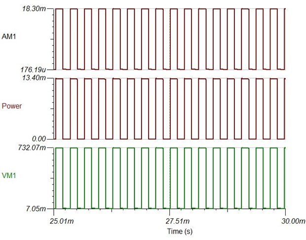

Here is the second half - the oscillator. I've just connected it with the 22nF capacitor. There's a voltmeter to measure the voltage across the speaker and an ammeter to show us the current through it.
Here are the waveforms. The waveform in the middle is computed by the simulator - I just asked it to multiply the volts by the amps to show power. It looks like the average power to the speaker is about 7mW. That's not all that much but we should be able to hear it and it keeps the power consumption of the probe quite low.

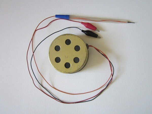

    jc2048 over 9 years ago in reply to jw0752
    This is the one I built a long, long time ago, in case you want ideas for the case. The tin originally contained tobacco (it came from my paternal grandfather who smoked a pipe).
    Personally, I'd use a 'scope for debugging - it tells you much more than a logic probe ever can - but if you think a logic probe would work for you then why not.
