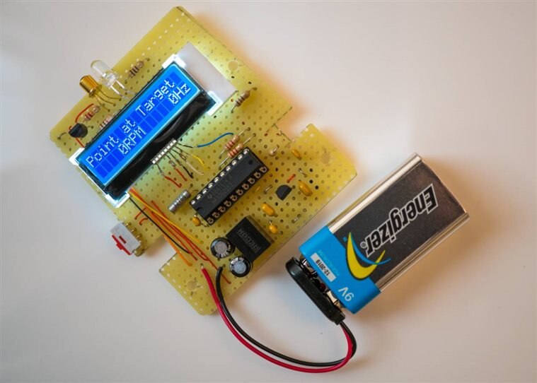

This project is to build a handheld test tool, to measure how fast things are turning. It could have uses in vehicle diagnostics, or for checking how fast a drill is spinning. It could also be used in math/physics experiments to see how fast wheels or other parts are revolving. Basically if any machine is spinning you can measure its rotational speed in revolutions per minute (RPM) or revolutions per second (Hz).
The short (60 second) video here shows it in action:
It is low-cost (<$25) and easy-to-build, so it could be ideal as a beginner 'learning electronics/learning to solder' project. All parts and details are published in this blog post.

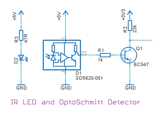

The principle is really simple; an infrared LED shines light on the target object. Reflections get sensed by a single photodiode 'eye'. Provided there is a reflective portion of the target object and a non-reflective portion (as an example, a piece of white tape could be stuck on a dark colored object, or a piece of black tape on a light colored object) then the reflected light occurs in pulses directly related to the number of revolutions per minute. The pulses are counted by a microcontroller every second and shown on a LCD display.

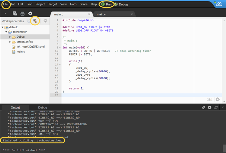

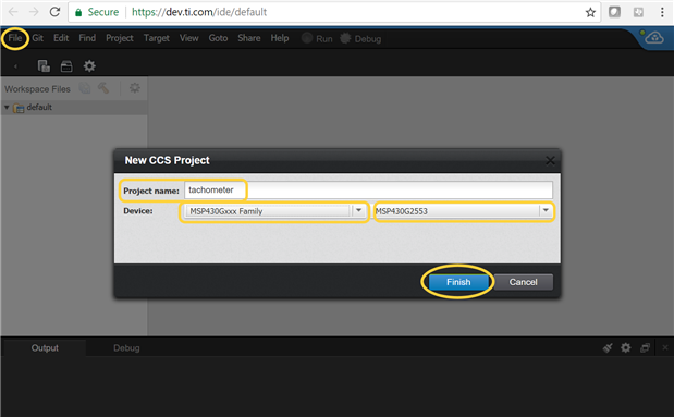

Go to File->New CCS Project and give the project any name (e.g. tachometer) and for the Device field select MSP430Gxxx Family and MSP430G2553.
You’ll see that the CCS Cloud environment has created a file for you called main.c and it has a basic main function already inside in the editor pane. It will look like this:

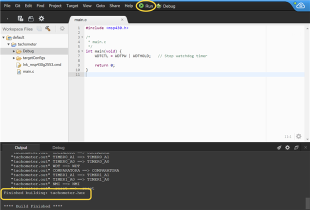

As a test, click File->Save and then click on the Hammer icon which is used to build the code into an executable file. The text in the Output pane will indicate Finished building: tachometer.This proves that the compiler is functioning. In order to download the code into the microcontroller plugged on the development board, all you need to do is click on the Run icon. The first time you do this it may download and install a little helper program to perform the transfer, and subsequently you don’t need to install anything to the PC.
The program doesn’t do anything, so you may wish to experiment and blink the LED on the development board. To do this, type the following code into the Editor pane:

Select File->Save then click the Hammer icon, confirm the Output pane successfully says Finished building: tachometer.hex, and then click the Run icon.
After a short pause the code gets transferred into the development board microcontroller, and the red LED should flash rapidly as the code was written to do. The executable file is written into non-volatile Flash memory, so if you unplug the USB cable and then re-insert it, the LED will start flashing again.

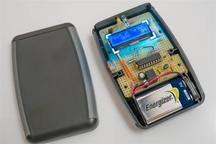

There are different ways to build the circuit; for example using isolated pad proto board, or using a printed circuit board (PCB). To build it on a PCB, the computer aided design (CAD) files are sent to a PCB manufacturer; the typical cost is $20 for 10 boards. One PCB manufacturer is iTead, but others offer similar prices and results too. To use iTead, search for their PCB prototyping service, and purchase their 2-layer 10x10cm board option. Then go into your iTead account order and click on 'View Order' and there will be a button to upload the CAD files. The PCB CAD zip file for this project can be downloaded from github and uploaded to iTead as a zip file. That’s it! The PCBs should arrive within a week or two.

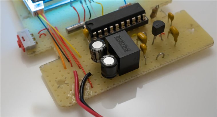

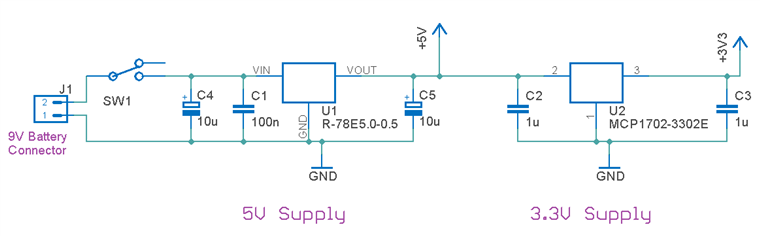

I initially built mine on isolated pad proto board. To start off, the power supply circuit is built. It can be verified by plugging in a battery and using a multimeter to confirm 5V and 3.3V outputs are functioning.

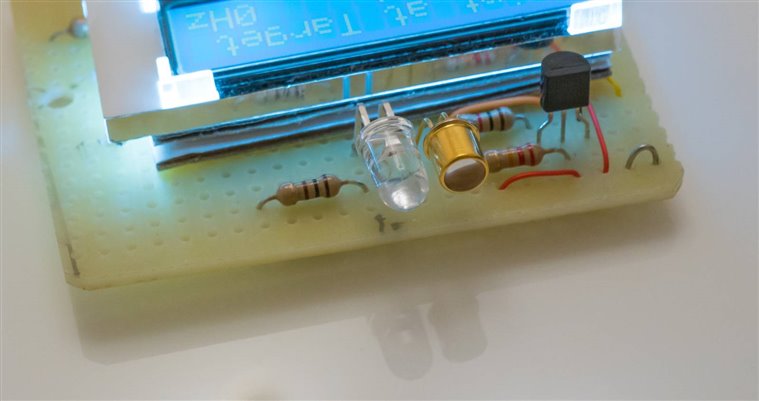

Next, the optical portion of the circuit is constructed. It consists of an infrared LED, and a photodiode circuit that amplifies the received signal and then provides a high/low logic output. The output is inverted and converted to a 3.3V logic signal using the Q1 transistor.
To test this circuit with a multimeter, placing white card to cause a reflection should result in the signal output from Q1 to change from high (3.3V) to low (0V). Careful adjustment of the angle of the LED should allow for a reliable distance of about 10cm from the target using a white card target.

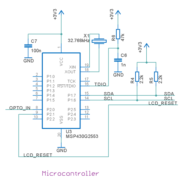

The output from Q1 is connected to the microcontroller. The microcontroller circuit consists of a 20-pin DIP socket for the MSP430 series microcontroller, a reset circuit (R6 and C6), a 32.768kHz crystal, a supply decoupling capacitor (C7) and two pull-up resistors (R4 and R5) which together establish an I2C serial bus.
The microcontroller that was programmed earlier can be plugged into the 20-pin socket once the entire circuit has been soldered.

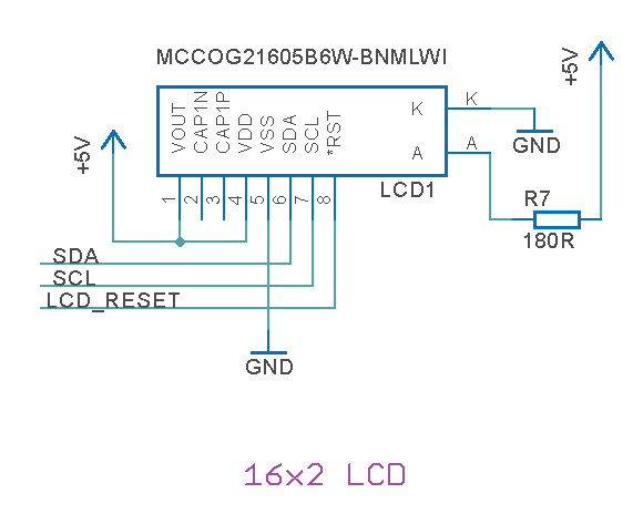

The final part of the circuit is to attach the LCD display.
And that’s it! The circuit is very simple. Plug the microcontroller in, connect a 9V battery and everything should work. The LCD display will prompt you to point it at a rotating object and the display will automatically indicate the RPM value and the number of rotations per second too (in Hz).
Any questions, please feel free to discuss in the comments section below. Also, if you do improve the hardware or software it would be great to hear about it.

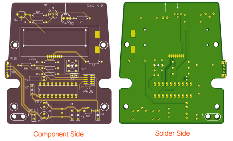

PCB Version

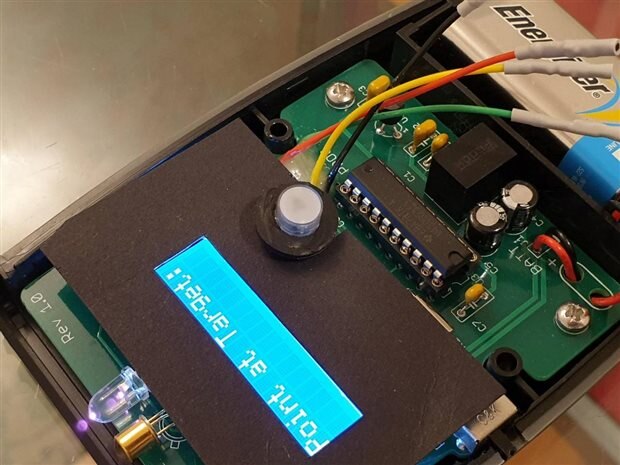

The PCB has a couple of optional features, in particular there is space for a push-button. It could be useful to implement new functions for example min/max display of speed where the speed is varying over time, or a ‘high-res’ mode where very high granularity is needed for the RPM measurement, or a 'counter' mode which just counts number of rotations forever until it is reset.
The PCB version is quicker to build and there is less chance of error during assembly.

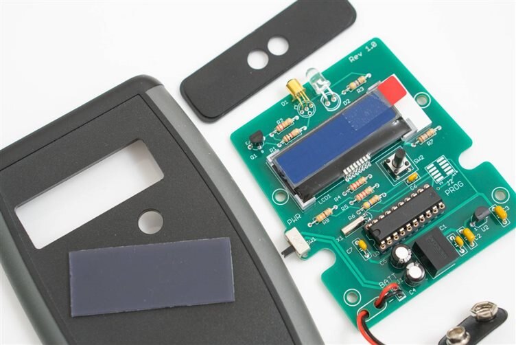

Final Test and Assembly

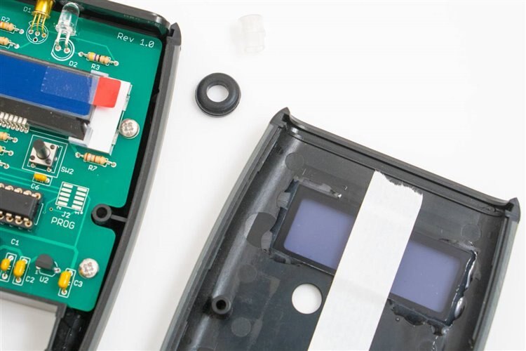

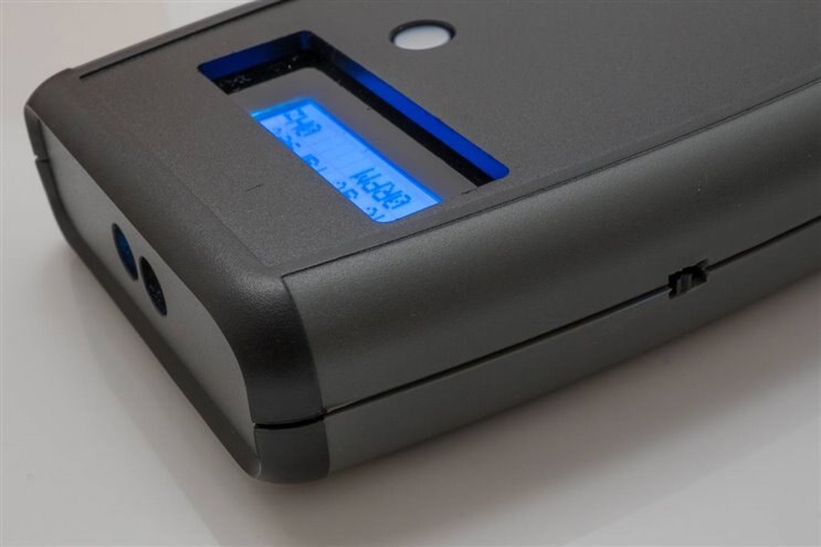

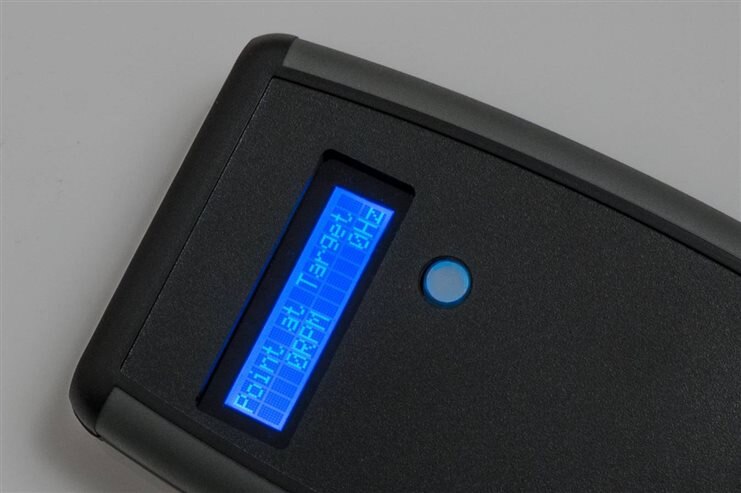

The project functions to speeds beyond practical limits for rotating objects. To prove this, I pulsed an LED at known frequencies and pointed it at the sensor. It worked to beyond 15,000 pulses per second which is close to 1 million RPM. The entire project fits in a handheld casehandheld case; a window will need to be cut for the display, the optical parts and the power switch. Alternatively a 3D printer could be used to create something suitable.
The window was cut to be larger than the text display area, so that the text would be visible from an angle too.
The window was fitted with a neutral density filter. This was glued on the inside of the case. For the push-button, I deliberately drilled a bigger hole so that a plastic cap that I had lying around (it wasn't designed for the specific push-button that I used) could fit. Other cylinder shaped plastic pieces could be used.
It turned out that I didn't need to glue the cap to the push-button; it just sits on top loosely, and is fitted with a lip (I used a grommet) around it so that it won't drop out of the case. Since there is a lot of light bleed from the sides of the LCD, I cut a black piece of card to act as a surround and lightly glued it down (I used 'glue dots' so that it can be easily removed if necessary).
Here are some final photos of the assembled device:

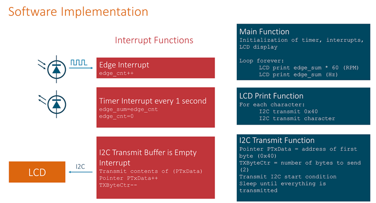

To examine it, look at the function called main(). The software sets up the crystal oscillator, and then sets a hardware timer inside the MSP430 chip to repeat every second. When the timer reaches one second the hardware will automatically call an interrupt routine. The main function also sets up another different interrupt to occur each time a falling edge signal occurs on the microcontroller. The edge interrupt pin is connected to the optical circuit.
The rest of the main function just loops forever, waiting for a fresh edge sum to be available, and printing it to the LCD.
Whenever the edge interrupt occurs, a counter is incremented. Whenever the 1-second event occurs the counter value is published in a global variable called edge_sum and then the counter value is reset.
Therefore the global variable edge_sum contains the total number of transitions that occurred every second. This value is multiplied by 60 to get an RPM value.

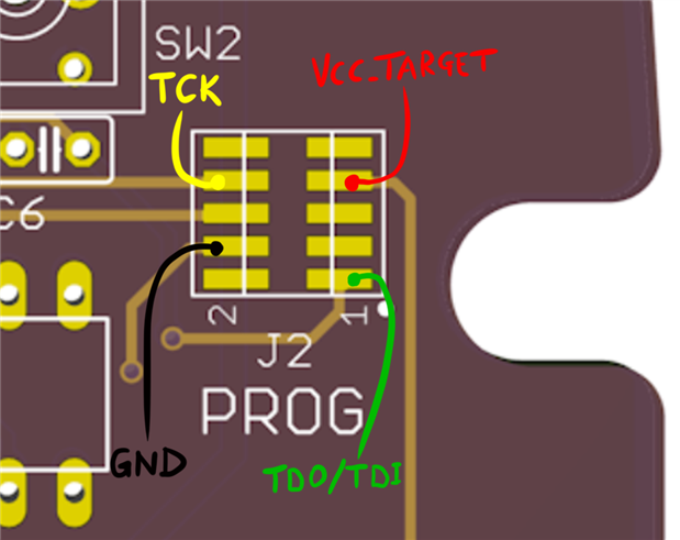

MSP-FET Debugger Wiring
Although it is not essential for this project, optionally if you have an MSP-FET programmer, then it is possible to use that to program or to debug the code. The MSP-FET is Texas Instrument's programmer/debugger tool for these MSP430 chips.
The diagram here shows how to wire it to the MSP-FET programmer. There are four connections to be made, and these names are labelled on the back of the programmer:
To make the connections, a 1.27mm cable and connector could be used, but it is easier and cheaper to directly solder to the pads. I soldered jumper wire sockets, so that they could be extended with male jumper wires, to connect to the MSP-FET.
I used some epoxy glue to make sure the wires don't break off. When putting it all in the enclosure, the wires will tuck out of the way.
