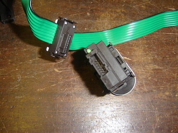

First off I took all the items out of the box and had a good look at them, everything looks good and solid and the cable took me back to building up computers.

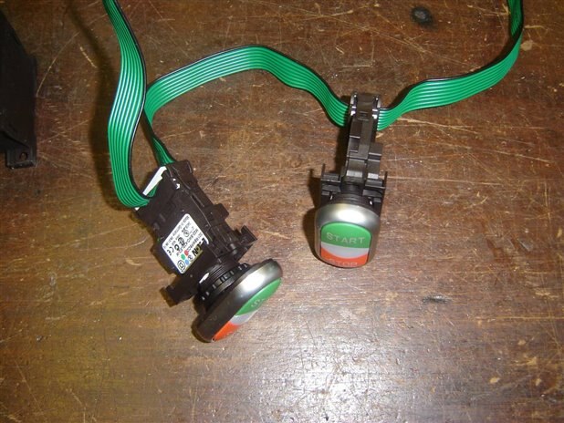

I had a look at the documentation and it all looked simple enough. I started by clipping together the two button units, just click them all together and all done. It has a strange connector on the back, I took to thinking of them as all having USB plugs.
Simply plug in the green flat cable and play!
