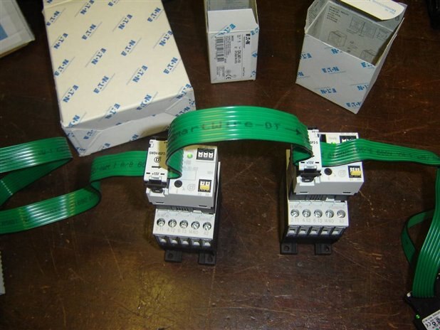

The kit consisted of:
1 x Programmable Relay – EASY802-DC-SWD
2 x Contactor Adapter DIL-SWD-32-002
2 x Contactors DILM7-10
2 x twin push buttons with LED M22 Modules
1 x flat cable with fitted device plugs
1 x Terminating Resistor
1 x 24V power supply
1 x USB cable
1 x easySoft-Pro V6.90
First off I took all the items out of the box and had a good look at them, everything looks good and solid and the cable took me back to building up computers.

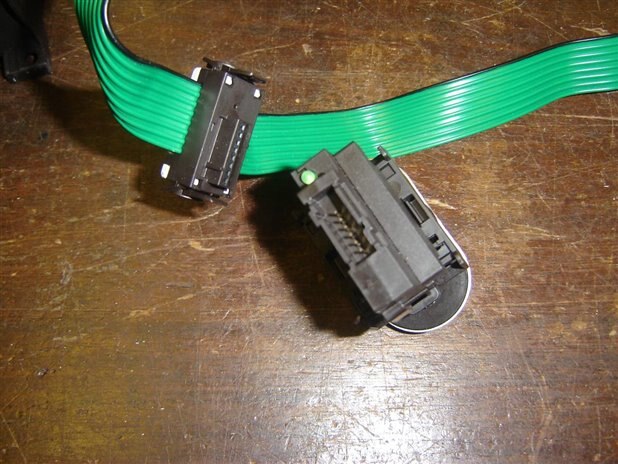

I had a look at the documentation and it all looked simple enough. I started by clipping together the two button units, just click them all together and all done. It has a strange connector on the back, I took to thinking of them as all having USB plugs.
Simply plug in the green flat cable and play!
Next I fitted the Relay Modules onto the contactors and again connected up the same green flat cable.
Finally connect up the Controller unit to the flat cable and your all setup.
