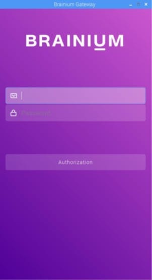

3. Toopen the Manage GUI type the following:
brainium-gateway-gtk
It is important to note that toperform step 3, it is necessary to have our raspberry connected to a monitor orLCD screen. Since when executing the command of step 3, we will open aninterface like the one shown in the following Figure 1.
Figure 1, Brainium Login

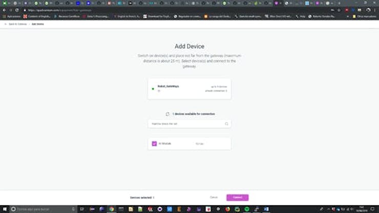

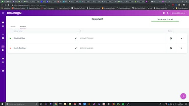

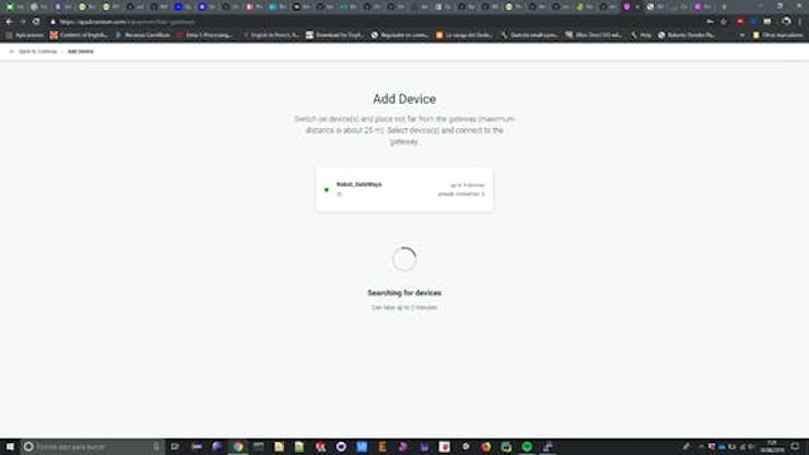

In this interface it will benecessary to authenticate ourselves with our credentials, it is assumed that wehave already linked our device to our brainium account. The only thing we willdo is change the Gateway to which our device was connected (Figure 2).
Figure 2, Searching Device
Figure 3, Adding Device
Figure 4, Selecting the Gateway

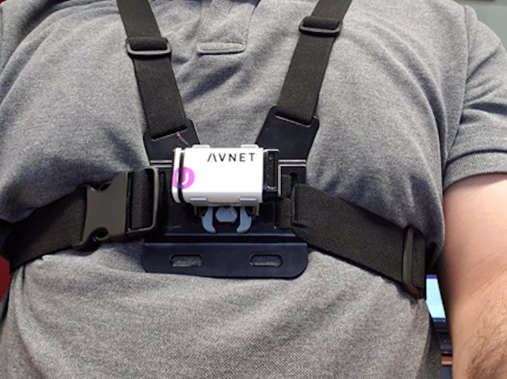

Once our device is linqueado andwith the correct Gateway activated in our console, the next step is to startcapturing the information (exercises). It is important to point out that theexercises to be classified are exercises in which the movement of the chest isinvolved, this is why it is necessary to use a harness. This harness willattach our sensor to the chest as shown in the Figure 5.
Figure 5, Sensor and Harness Joined

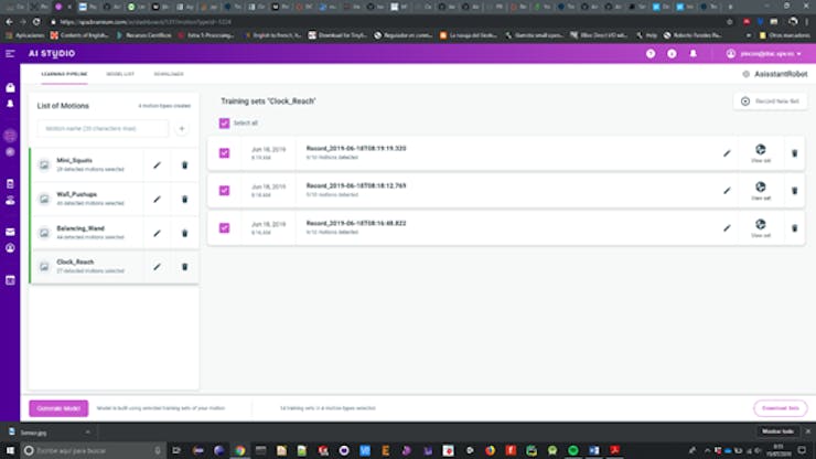

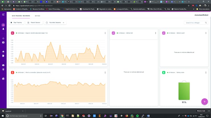

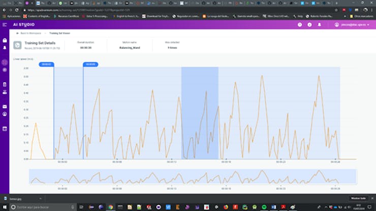

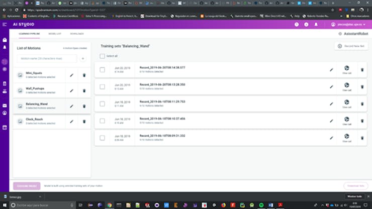

Once the sensor is in position, the next thing to do is to start capturing the data, for which the differentexercises were performed. Performing 5 sessions of 10 repetitions per exercise shown in the Figure 6.
Figure 6, Section of the 5 exercises
Figure 7, Graph of one of the exercises

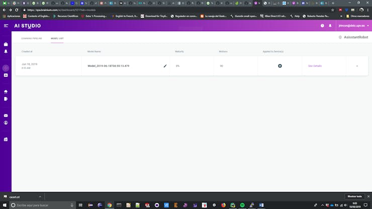

At the end of the dataacquisition phase, the next step is to train the model. To do this, select allthe samples from each of the sessions and click on general model (Figure 8).
Figure 8, Model Generation
Once the model is generated, we will see a screen like the one shown in the following Figure 9.
Figure 9, Generated model

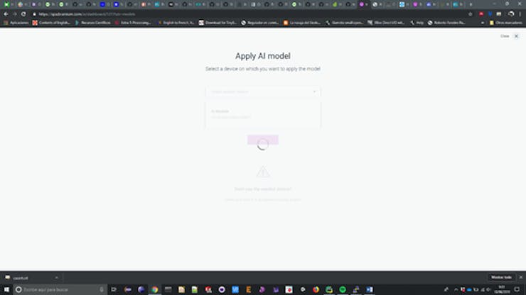

The next step is to apply ourmodel to our device (Figure 10).
Figure 10, Applying the model to the device

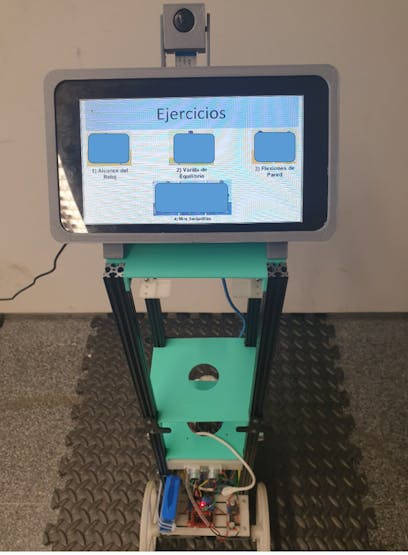

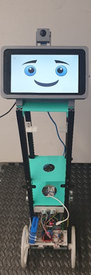

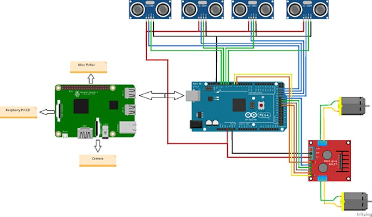

Once the configuration of thesensor and the acquisition of the data to be trained has been carried out, thenext step is to use the robot to track the activities. The robot used can be seen in thefollowing Figure 12, this robot was built using a raspberry pi 3, a 7" LCDscreen, a camera, some makebeam for the structure, a mega arduino (motorcontrol) and two DC motors. The robot responds to voice command, using the Snips system (https://snips.ai/). Using this voice recognitionsystem, the user can interact with the robot using his voice. In this way, theuser can request a recommendation for some type of physical activity. Three mqtt clients have beencreated to control the robot, one that controls voice recognition andrecommends activities. The next client controls the motors and the camera andfinally a third client acquires the information from the environmental sensors ofthe Rapid IoT device.To launch these clients, a"sh" file called "./run_snips_emir.sh" was created, whichautomatically executes the three python scripts:
#!/bin/bash
python3 action_emir_v_0.0.1.py &
python3 mqtt_iot_publish_data.py &
python3 mqtt_robot_publish_data.py &
wait
The robot has 4 ultrasonicsensors, which are located at the front of the robot, right, left and one atthe back. These sensors are controlled through an Arduino mega and thedistances are sent through the serial port to the raspberry pi to the client mqtt_robot_publish_data.py. Once the client receives the information from the sensors, it publishes them tothe main client. At the same time, the client mqtt_robot_publish_data.py is incharge of controlling the engines, sending the different commands by voice, such as move forward, backward, left and right.
Figure 12, Assitant robot

Figure 14, The robot shows the different exercises
