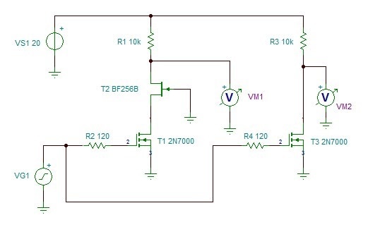

Here's my circuit. I used a 2N7000, instead of the BS170, for the simulation because of difficulties
with importing a model for the BS170. They're very similar, though, in the way they behave.
Because the Idss [current when Vgs is zero] of the BF256BBF256B is only about 9mA, I'm going to need to
keep the load current a good bit below that, so my load is a 10k resistor. With the rail at 20V, that
will give a current of around 2mA when the switch is on, which is well within the capability of the
JFET to deal with.

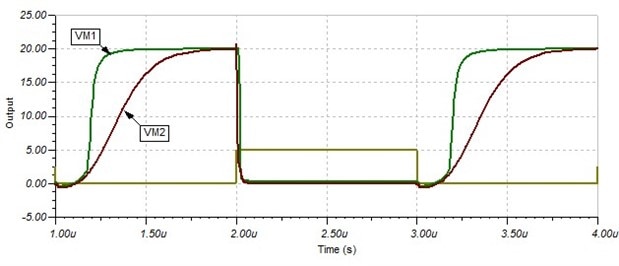

Here's how it looks in the simulator:
Although there are some minor differences [which we'd expect, as the actual devices won't perfectly
match the typical figures used for the models], the essential features of the waveforms are all
there, so the simulator is modelling the active devices reasonably well.

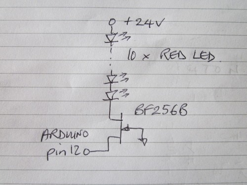

The circuit I'm experimenting with here isn't particularly useful with these small-current
components. There is, though, one thing I could try with it. As the bottom transistor stays in the 0
-5V range, instead of having a separate discrete transistor I could just substitute the one that's
inside the processor driving the I/O pin. Also, since the JFET will regulate the current to about
9mA, it would make a reasonable LED driver. So something like this might work quite well, as long as
I keep an eye on the dissipation in the JFET.
And it does work. Some flashing LEDs, in case you've never seen them doing this before.
Here are the switching waveforms. The yellow trace is the output pin of the Arduino and the blue
trace the voltage at he bottom of the string of LEDs.
The pin output does indeed stay between 0V and 5V. The blue trace comes down to about 6.8V when
they're on, so that's about 1.7V for each LED. When they're off, you'll notice that the voltage only
rises to about 11V. That's because the diodes have a reverse capacitance that's only going to be
discharged by leakage currents (through the LEDs and the JFET) and the oscilloscope probe (10M to
ground). It's possible, I suppose, that I've inadvertently contrived a situation here where I've got
the leakage currents cancelling each other out because it doesn't move very far at all during the
half-second off period.

    I have a question about the last part, where the IO of an Arduino is used. How do you turn Arduino pin 12 into an open collector configuration? Or is that not needed?
  • jc2048
    jc2048 over 5 years ago in reply to Jan Cumps +2
    I didn't. The upper MOSFET on the IO driver is clamping the IO pin to 5V when the output pin goes high. I would think that's why the pin waveform manages to stop so nicely when it gets up to 5V and not…

    If I set the output pin low and then control the direction, so that only the lower MOSFET is active, I see this
    This is then similar to what I had with the discrete MOSFET. That shows nicely the way that the JFET turning off shields the output from the load voltage. Bear in mind that I'm using a JFET intended for VHF work and it's [just about] keeping up with the processor's MOSFET.
    This is the code, in case anyone's interested.
    /* cascode switch test
    Repetitively sets UNO pin 12 active low for half second, then off for half second
    This is specific to UNO.
    void setup() {
      PORTB &= ~0x10;
    void loop() {
      while(1) {
        DDRB |= 0x10;
        delay(500);
        DDRB &= ~0x10;
        delay(500);
