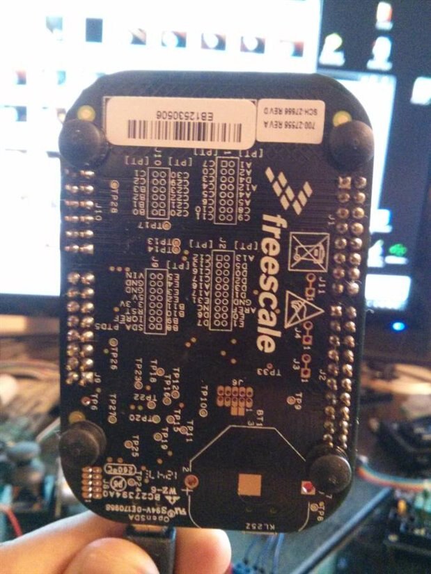

The Freescales FRDM-KL25Z Platform comes in a nice little package and at a great price, but it does not come with much needed headers for utilizing shields.

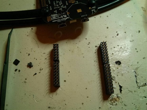

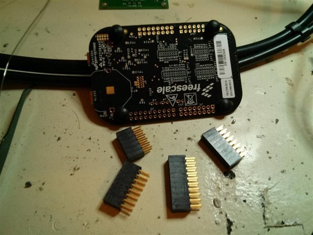

I'll start my advantures with this board by soldering on the 4 different headers. These are the headers that I ordered: 2 2X8, 1 2X6 and 1 2X10.
Keep in mind, if you have longer headers you can always cut them down to size.

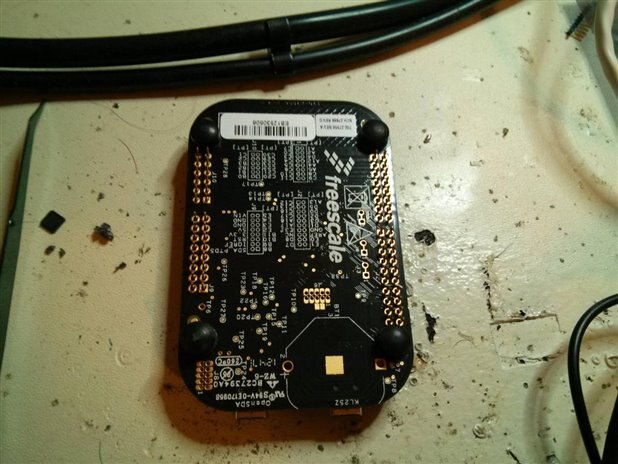

I notice that laying the board down with the headers up keeps them centered, so I lay the board on my work bench and solder 2 corners of each header utilizing this method.

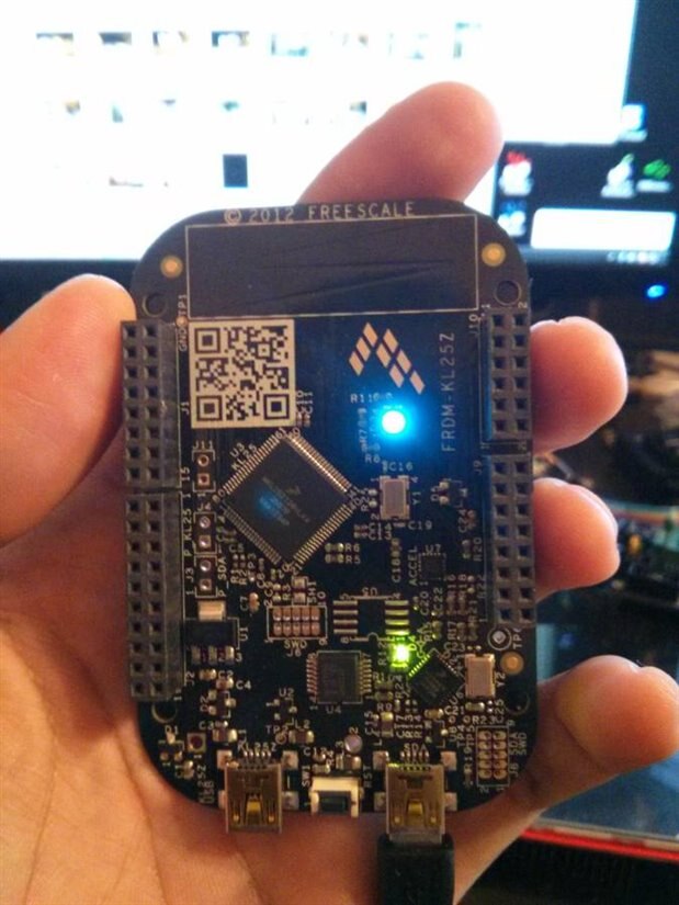

I take a look to make sure everything is flush, finish soldering up the rest, and then place a shield on just to be sure.
Everything seems to be in order and I'm now ready to see what I can do with CoCo and Mbed.
