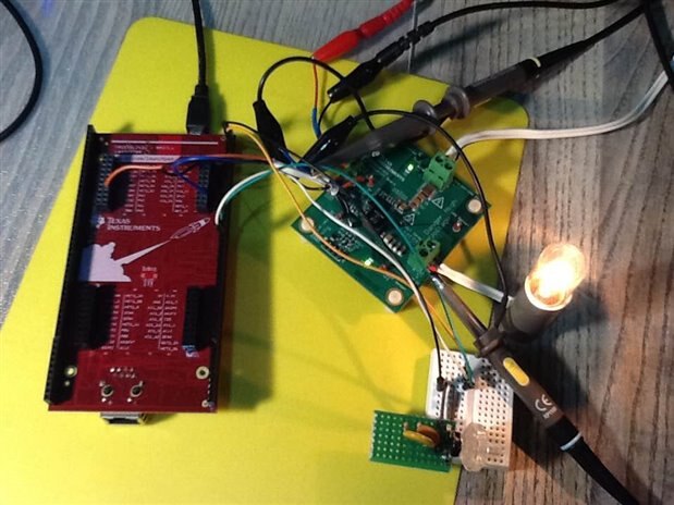

    Jan Cumps over 10 years ago
    ... and a last one for good measure.
    The setup is completed now. I'm going to write my article...

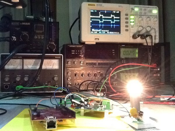

    And an action shot:

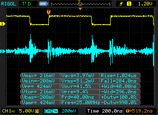

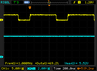

    Here's a raw capture of one of the inputs, and the output signal in DC modus and AC modus (to see noise on the output):
