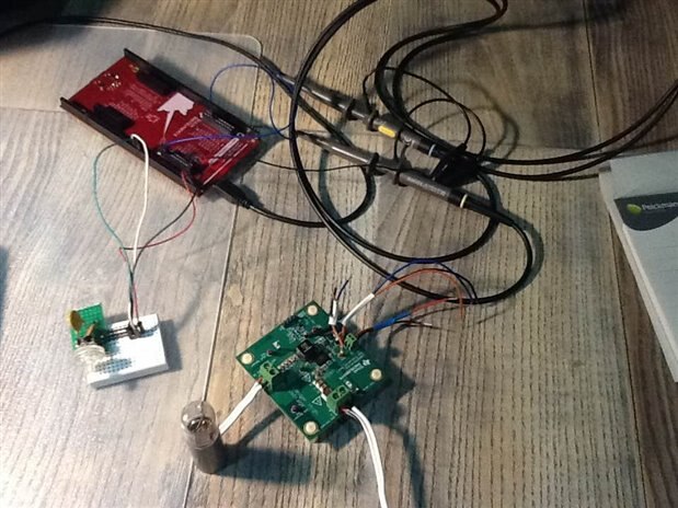

In this post I'm building a PWM deadband generator with a Hercules LaunchPad.
PWM with Deadband
To drive our GaN half-bridge, we need two complementary PWM signals.One to drive the upper FET, the other to drive the lower FET.
When one is high, the other has to be low. The worst thing that can happen to a half-bridge is that both FETs are conducting. So we have almost covered that.
Almost, because we need more. For a tiny amount of time during switching, we have to take care that none of the FETs are on - the Dead Time or Deadband.
For an explanation of Dead Time, check the previous article in this series.
My goal in today's blog is to create that signal with a Hercules LaunchPad PWM module. This is the signal we're after - the hatched areas indicate where both signals (and both FETs) should be off:
Each PWM module of the Hercules controller has a pair of outputs (A and B) that are tied together. They act together, and can be used to generate tightly coupled signals.
By default, the B signal is the inverse of A. When A is high, B is low and vice versa. But you can change that.
One of the things you can change is introduce a delay in the rising edge and the falling edge. That's what we're looking after.
Both signals should have a delay on their rising edge, so that that edge only happens at a given time after the counterpart's falling edge.
If  we manage to do that (and we will image), we have what we need. A set of signals that are each other's compliment, but have a gap between one switching off and its partner switching on.

    This is a capture of input pair signal to the GaN FET. I'll measure the output soon - maybe today if everything goes right.
    I have to hook up the driver to the Hercules microcontroller, and do some prudent tests before using it with higher loads.

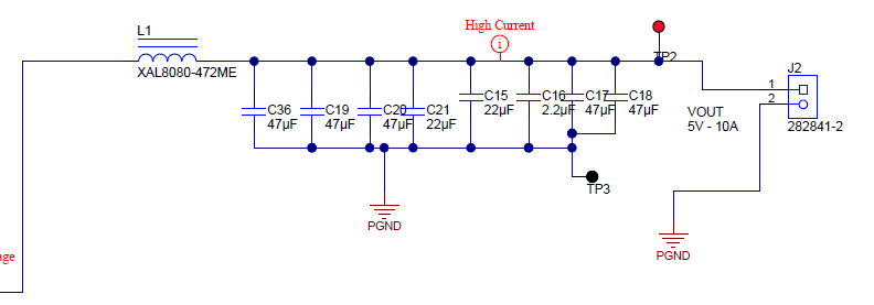

    Here's the output filter. Let's see how smooth it can keep the signal that's going to the load:
    L1 = 4.7uH
    I'll post here as the tests unroll...

    Here is a short capture of a successful tryout:
    I'm scrolling a mouse wheel left and right. The signals duty cycle should (and does) follow.
    Signal A en B are never high together (bridge would shortcut if they do).
    There's always a dead time (where two signals are low) before a signal switches high (the purple trace shows the deadband, a calculation of the sum of the two signals A+B). Requirement for this GaN power bridge.
