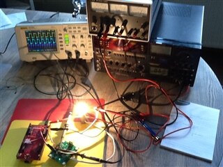

In this post I'm building a PWM deadband generator with a Hercules LaunchPad.

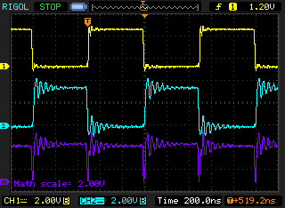

On the oscilloscope, you can see the output of both PWMs. I've added a math A+B signal to show that there's a time where both signals are low. The Deadband.
Fig. 3: Bart Simpson looking over the wall
In this article, I've exaggerated the times to make everything more visible. To drive the LMG5200, we'd choose delays around 6 or 7 ns.
All parameters are runtime configurable. So we can change PWM frequency, duty cycle and delays from firmware. Each can be changed without impacting the other parameters. Full control, anyone?

    Is the ringing from the long test leads or are they artifacts of the circuit? DAB
    Jan Cumps over 10 years ago in reply to DAB +1
    Yes, I'm not doing anything about the ringing. It's a by-product of a prototype setup with not-my-best-effort-probing. No decent looking scope trace to be expected from what you see below with patch wires…
    Virtually all ringing comes from my setup. I'm running a 1MHz digital signal with fairly short edge times, and I'm using patch wires and what have you in the circuit.
    I just wanted to check if the signals are inverse, and if there's a dead band after on signal switching low and the other turning high.
    Signal integrity was not something I was working on today, just verifying that the logic is fine.

    Yes, all is probed with open outputs, so the signal ends with high impedance and ringing has free game image.
    Also the sloppy probing technique I used in today's blog doesn't help too much to guarantee signal integrity.
    If I would have loaded - and properly damped - the signals, you's see something that resembles a square wave. And the risk to get noise is reduced when the signal sees a load.
