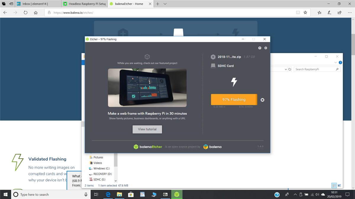

The next step in the process was to install an image of the operating sytem on the SD card, which required Etcher. So I had to download Etcher, guessing I wanted the 32 bit version. This worked surprisingly quickly and well and, as it turns out, can use the zipped image of the Raspberry Pi operating system, so I didn't need the 7zip programme after all. Then I just etched it. See below for it nearing the end of the process:

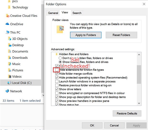

What they do not tell you is that at the end of the etching process the SD card is automatically unmounted and disappears from the Windows screen. I had to remove and then re-insert the SD card in order to be able to add the file called ssh. It is a bit unclear what this file should be. The tutorial said that it should not have a file extension but it is still listed as a text file in the example screendump. So I just copied an existing text file, deleted the contents and renamed it ssh. It still has the .txt file extension but this is not displayed, so I hope this is correct.

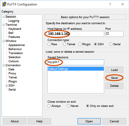

I now had to download Putty which was pretty painless. I thought I was on the home stretch now, but alas it was not to be. I entered the IP address I had but no matter what I did, it always failed saying connection refused. So I'm giving up for the moment.

    Regarding the ssh file, it must have no extension (I've never tried it with an extension, but I believe it won't work). Normally I just right-click in the file explorer, and select New->Text Document, which by default has a .txt suffix, but I delete it. For this to work, the File Explorer options must be set to always display the extension.
    Then the file can be created in the top level of the SD card:

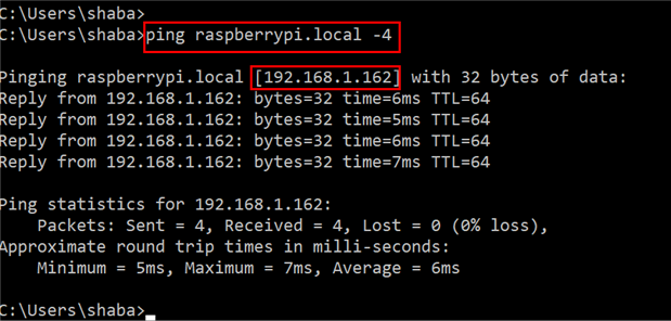

    Method 2: Try to ping raspberrypi.local
    To do this, type the following in a windows command prompt (the -4 is used to force IPv4 pings):
    ping raspberrypi.local -4
    and look for this response:
    That IP address can now be attempted using your SSH client software, e.g. PuTTY:

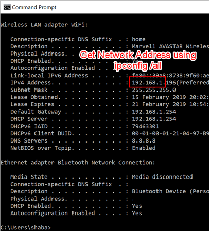

    Method 3: Just try to ping random addresses! Figure out if your network is on 192.168.0.xx or 192.168.1.xx, by opening up a windows command prompt and typing:
    ipconfig /all
    Look for this information:

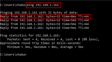

    Now you can randomly ping stuff until you get a response:
    and then see if it is a Pi by trying to SSH to it using your PuTTY software. There are tools that try to ping all addresses to narrow down the list of choices, but it still takes a while : (. Method 1 or Method 2 is better.
