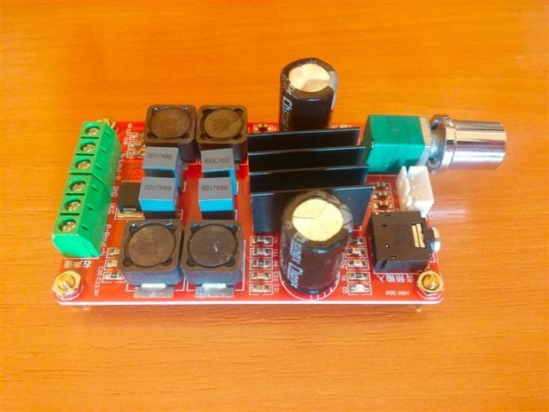

I used a breadboard. There were no Fritzing shematics so I made my own. The original design uses a female jack for output and you connect Glitch Storm to an amplifier. My schematic uses an 8Ω speaker as output and a small 2x50W PCB amplifier in between the build and the speaker.

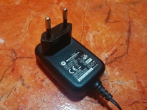

  • a MiniUSB cable for power (I used an old Motorolla cellphone charger that has an output of 5V and 550mA)

  • any amp board that can hande 5V and 2A power and 8Ω/50W speakers
The amplifier board and the speakers are optional. You can use your own aplifier device and headphones if you like. Four of the resistors serve as circuit protection for the LEDs and are optional.

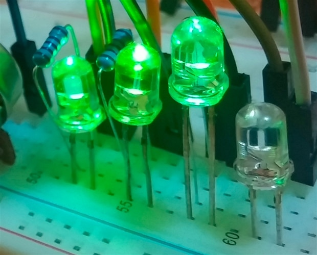

The minus leg of the LEDs goes to Ground and the plus (the longer leg) of the LEDs are connected to a 1k resistor that then is connected to D7, D8, D9, respectively D10 pins of the Arduino Nano. The middle leg of three of the pots (used to modulate the sounds) go to the A0, A1, respectively A2 pins of the Nano board. Left leg goes to a Ground pin, the one on the right needs to be connected to the 5V pin of the Nano. One side of the two momentary push buttons goes to ground and the other to D2 and D4 respectively. Connect D11/MOSI on the Arduino to one leg of the ceramic capacitor and the other leg connect it to a Ground pin. Connect the fifth resitor to the same D11/MOSI pin and the other leg of the resistor connect it to the "+" (longer) leg of the electrolitic capacitor. The short leg of the electrolitic capacitor goes to the right pin of the last potentiometer, the left leg of the potentiometer goes to Ground and the middle one will be connected to the plus hole of the amplifier (while the minus part is connected to one of the Ground pins of the Arduino Nano).
You connect the Arduino Nano to the USB port of your computer or any other power source capable of outputing 5V/2A and the code does the rest. Weird sounds start blating through the speaker. The fourth pot (the last one we connected) is the volume potentiometer. Turn the other three to make sounds. Use the two buttons to generate new sounds ot keep one button pushed for about five seconds and the Nano will go through sequences of algorithms and generate even more interesting sounds. The LEDs point out which sequence and what algorithm the Nano currently uses to generate the tones.

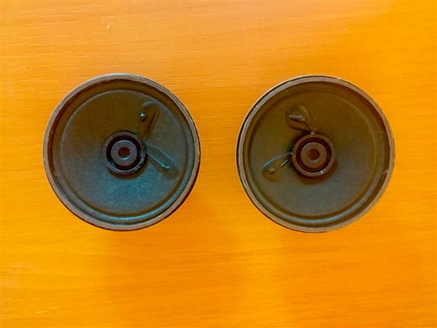

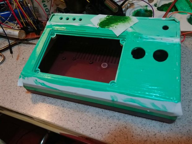

I bought a better amplifier board, some smaller speakers and a project box for the synth.
Here it is with the 50W amp board:

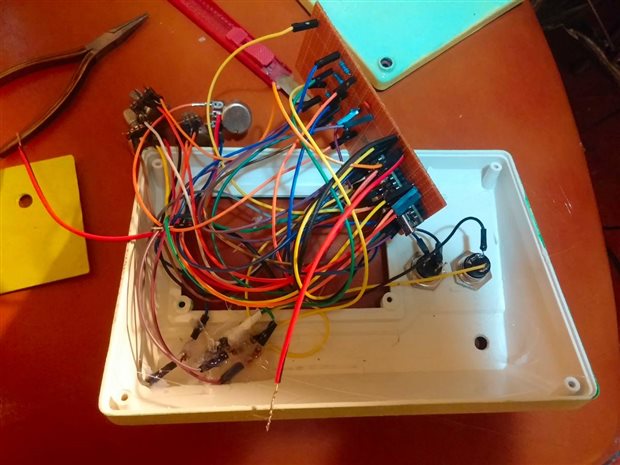

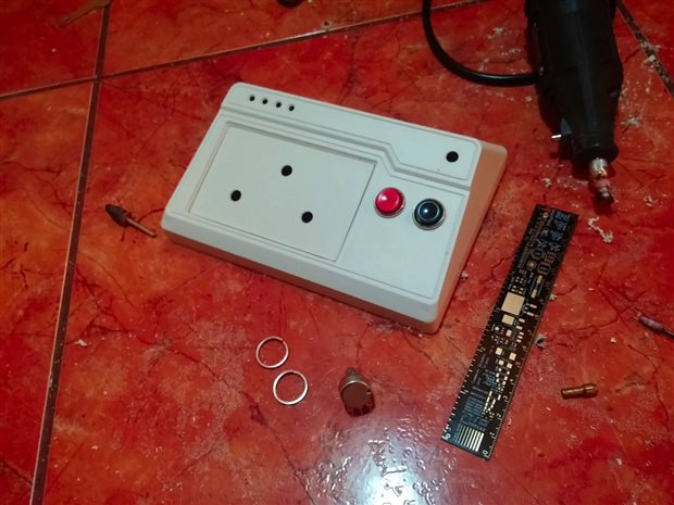

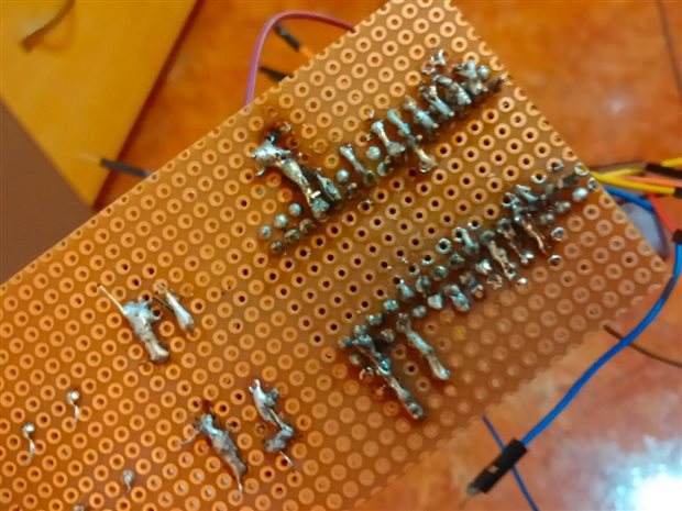

/January 7th update: decided to go with another box and started working on the prototyping board. Horrendous soldering skills but it works.
Started painting the box in more cheerful colors.
/January the 8th update:
The paint on the box is almost dry. Still needs a few corrections here and there but tomorrow I will apply a thin protective layer of epoxy resin on the box and let that dry too. It will make it glossy and it will brighten the colors.

/January the 9th edit: Almost done. Soldered everything and fitting it into the case on which I applied a thin layer of protective epoxy resin.
