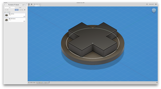

Instead of using micro switches for my buttons, I am re-using the silicon piece from an existing controller. In this case, it is from a USB SNES-like controller, so I’m not ruining a classic. I 3d modeled the pieces for that controller in Fusion 360, so I could design my layout.
The next step for the enclosure mill out the basic shape with some cheap HDPE, to see how it feels in my hands.

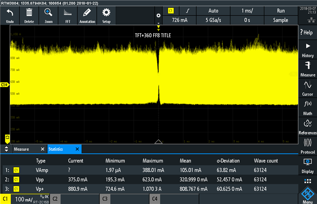

Using the current probe on my R&S RTM3004, I measured the current draw of the Pi with a PiTFT 3.5 inch screen attached. I took this step because my multimeter said the current draw was around 510 mA. However, check out this screenshot with my scope on infinite persistence.
There is a pretty significant amount of ripple current, meaning the Pi is drawing a bit more than what a multimeter shows. And since there is a ripple, that is not a surprise. The actual current draw appears to be closer to an average of 700 mA. There are spikes to 1 A. Especially at boot. Someday, I’d like to explore this aspect more, but that’ll have to be a future video.
My power for the build is an old USB power brick. Originally it was rated for 10400 mAh. However. It is at least 3 years old at this point and has not had an easy life. So I was not sure how much life was left in those cells. Last night I ran a battery life test. If it lasted longer than 4 hours, I would have been happy. Imagine my surprise when I woke up in the morning and IT WAS STILL GOING! So, I’m going to see if I can maybe use a smaller battery.
Note: This test was before I did anything to disable WiFi, Bluetooth, or change the screen brightness. Amazing.
