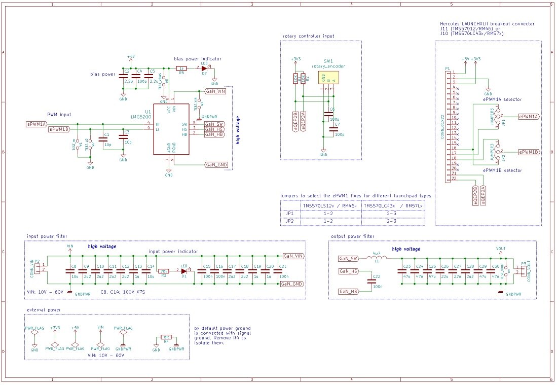

The Schematic

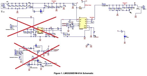

The EVM User Guide has the schematics for this board. I removed the discrete deadband generator and bias voltage provider.
The deadband generator is replaced by a connection to Hercules LaunchXLII PWM outputs. The bias will come from that same LaunchPad's 5V power.
Here's my version. No bias or deadband circuit.
I've added a quadrature encoder. This part, connected to the Hercules eQEP module, is optional.

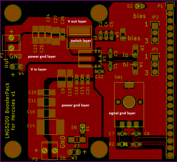

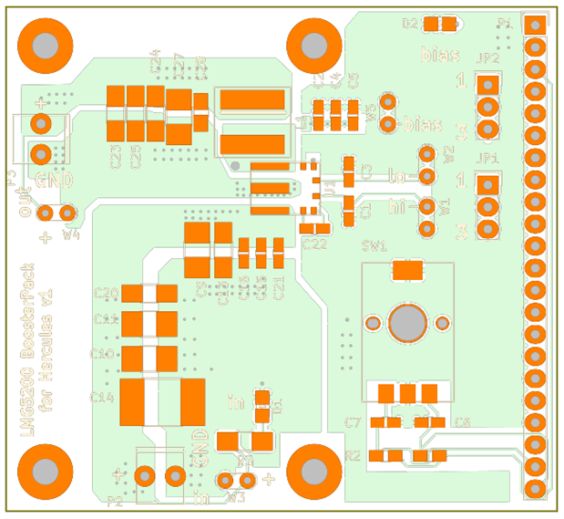

Here is my layout. You can compare it with TI's reference design images in my previous post.
Board Top (copper, mask, silkscreen, forgot to show the drill holes - see the image in the intro section above for those image)
White annotations are not part of the PCB design. I've added those on the blog image for clarity (and because jc2048 requested it image ).

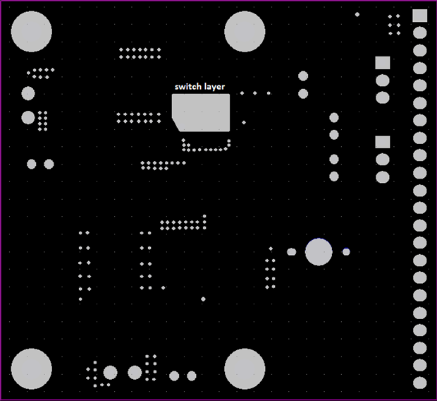

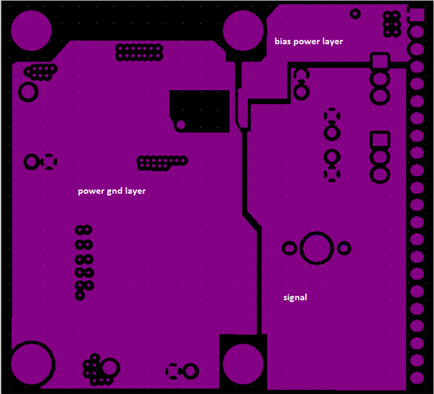

Middle Top layer
Middle Bottom layer
