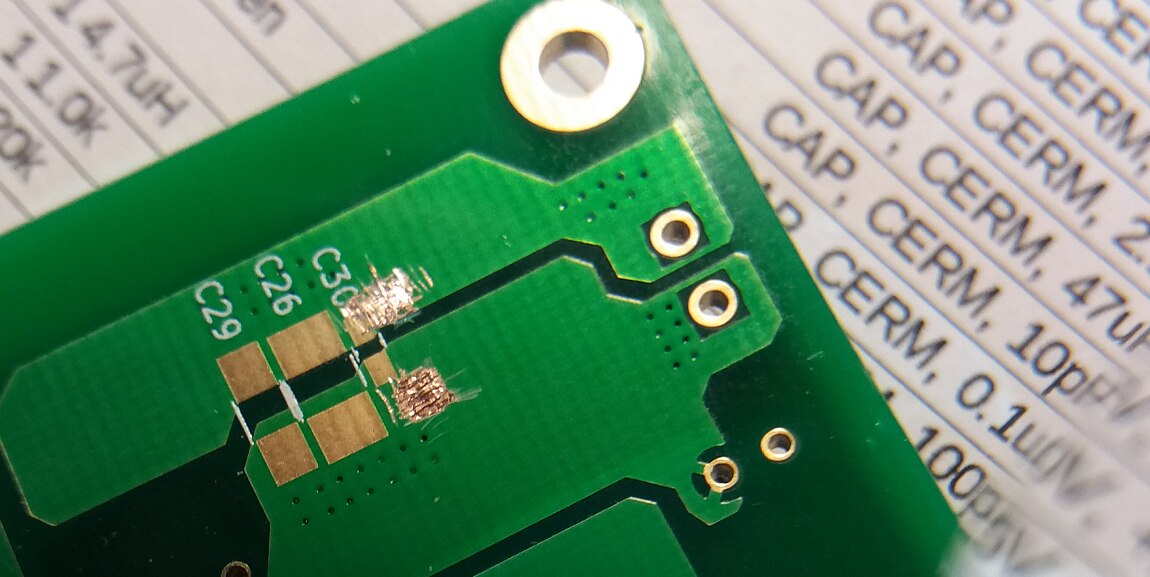

I'm designing a BoosterPack to evaluate GaN devices with the help of a microcontroller.
I've received PCBs from Seeed. Let's have a look ...

This is the first time I'll populate a two-sided board. I'll use hot air for the smd components.This is how I plan to approach it:
  1. solder the GaN IC and the inductor. These two have the pins under the device. I'll have to massively bombard them with heat to transfer the energy underneath where the solder paste is.
    I'll use the pre-heater that shabaz gave  me to get the whole board to a close-to-reflow temperature.
  2. then all the smd components on the bottom side. If they fll of later, that's not a big deal, because the are only few.
    I'll also use the pre-heater but on lower temperature, because its heat will be radiating on the inductor and GaN chip.
  3. Then I'll do the remaining top smd components.
    The pre-heater again on a temperature low enough to not desolder the bottom components.
  4. the trough-hole components by hand
It is my first time. I'd be happy to take your advice on the preferred order to solder the components.

    First error found: wrong footprint for C30:
