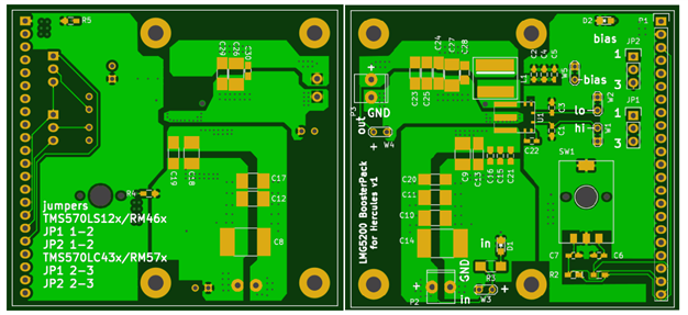

I'm designing a BoosterPack to evaluate GaN devices with the help of a microcontroller.
I've received PCBs from Seeed. Let's have a look ...

Just like previous designs I did with OSHPark, the Seeed boards look very good at first inspection.
This design is 4 layers, so I have no mechanism to look at the two inner layers. The top and bottom layer look very nice, so that's a good sign.
In the images below, the artist renditions on the left side are generated by the Seeed portal.
The photos on the right side are the actual thing. Click on them to get a detailed view.

    Jan Cumps over 9 years ago
    The board is built up, not tested yet.
    Reflow worked ok, except for 0402 and some 0603s.
    C22(0402) toombstoned, I had to rework C15, C21 and LED D2 too.
    I'm happy that the (somewhat) complex footprint of quadrature encoder - with one oval and two round mounting holes fitted perfectly.
    The two screw terminals however, P2 and P3, are a complete goof-up. The holes are too small, the distance between them is wrong and the total size of the footprints doesn't match the component.
    I have to check how that happened, because I made this footprint myself from the data sheet. (wrong part ordered or delivered, wrong drawing selected in the sheet, inch/cm switch, I don't know yet)
