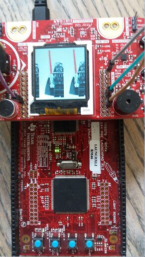

We know SPI as a 4*-wire protocol. But it doesn't have to be.
I'm checking high speed SPI data transfer with buffers, DMA and parallel data lines.
In this blog, I use DMA to hand over data to SPI and let it do its own thing.
SPI Performance will NOT Increase
In the previous blog, we already achieved maximum SPI performance. We're sending all data via SPI in one shot.
In that example we already achieved the maximum yield possible for our Baudrat The actual traffic speed can't go up by adding DMA.
Why would we use DMA then?
DMA to Increase the Troughput and Optimise the Data Channel
So the SPI Baud speed doesn't change, does it? Indeed.
The effective 'speed per bit' is at its maximum (for our current physical implementation with one SPI data line)
What changes though, is that we've freed up our microcontroller core during the SPI call.
In the previous Buffered example, the controller ticks were used to move buffer memory to the SPI module.
During that operation, we don't have the exclusive attention of the controller core.
With DMA, the SPI is running all by itself, and gets the data spoon fed by the DMA module.

void _writeData64DMA() {
    gioSetBit(_portDataCommand, _pinDataCommand, 1);
    mibspiTransfer(mibspiREG3, 2 );
    while(!(mibspiIsTransferComplete(mibspiREG3, 2))) {
If we provide more than one buffer, we can set up a round robin system.
We can fill pixels in one buffer while the SPI is outputting the previous one.
And that allows us to gain time. We don't have to spend time to prepare all data up front to have the buffered speed.
We can prepare just enough, and hand over to SPI and DMA.
Meanwhile, we prepare the next chunk.
The Example Program
As you can see in the photo at the beginning of the blog, and in the LA output, it has a bug.
The image i corrupted. I don't send the full data.
That doesn't matter for this blog, because it shows the mechanism. But it's not something to be proud of.
Hercules grey beards, please chime in if you know my error.
Part 3b shows the working version.
