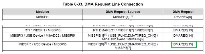

To make DMA work with the SPI module 3 of the launchpad, you need to know the request line to be used with this device.
The info can be found in the controller's technical reference document. We're ussing DMA channel 0, so the request line is 15.
void initDMA() {
       dmaReqAssign(0, 15 );

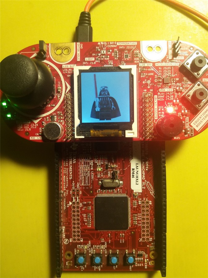

Then our program prepares the memory and hands things over to the SPI / DMA tandem:
void flashBitmapLineDMA(bitmap_t *bmp, uint32_t line) {
    _setWindow(0, line, bmp->width/2, line );
    loadBitmapInDMABuffer(bmp, line, 0);
    initDMA();
    _writeData64DMA();
    _setWindow(bmp->width/2, line, bmp->width, line );
    loadBitmapInDMABuffer(bmp, line, D_SIZE / 2);
    initDMA();
    _writeData64DMA();
The function that handles the notification to the SPI module is simple:
void _writeData64DMA() {
    gioSetBit(_portDataCommand, _pinDataCommand, 1);
    mibspiTransfer(mibspiREG3, 2 );
    while(!(mibspiIsTransferComplete(mibspiREG3, 2))) {
You'll see that the function waits for the DMA is complete. That's to make things easy for my program but it also takes away a possible advantage: doing something else while the transfer happens.
So there's still room for improvement.
All in all, it's fast already:
