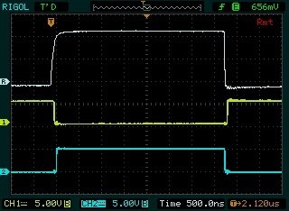

The high and low side of the bridge are controlled by an opposite signal. Both signals have a dead time inserted when one signal goes low and the other switches high.
GaN semiconductors don't need a lot of dead time. The setup here is configured for a 50 ns band.
*1: I was sloppy when capturing this scope window. The falling edge of the input signal should be where the orange line is. Check comments below for more info.
Thank you jc2048 for spotting this.
The scope capture above shows the input (low-power) signals.
The white line is the input signal, with 22% duty cycle and a frequency of 200 kHz.
The yellow line is the driver signal for the high side FET, the blue signal for the low side one. Check the schematic below to get an idea of where the 3 signals occur.
(excuses for the mismatch in scope horizontal scale setting between yellow and blue. I only saw this after I disconnected my setup. They have the same amplitude.)

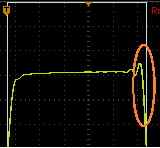

I'm going to probe the switcher's output signal. I'll zoom in on the overshoot positions, so you can see that the signal is behaving decently in the dead time.
This trace is a full high part of the output at 200 kHz, 22% duty cycle.
It gives an impression of the switching artifacts just before the edges.
A detailed capture of the rising edge overshoot looks like this:
The input signal is 60 V. The overshoot is approximately -8 V:
On the falling edge, there's less switching residue:
(the time scale is extended to the limits of what I can show on my scope screen. Check the full signal above to get an idea of how steep (50 ns) this ramp-down and overshoot is.)

    jc2048 over 10 years ago +1
    Good stuff, Jan. Thanks for posting this. The high side FET anticipates the input signal and turns off 50nS before it arrives? Something tells me that might not be right. Line drawn in wrong place? I take…

    Jan Cumps over 10 years ago in reply to Jan Cumps
    Ah, I happen to have an archived capture of input and hi-lo without me fluking the saved signal, from last Sunday.
    This is at 100 kHz though, half the PWM frequency as the blog above - and yellow and blue are swapped.

    Jan Cumps over 10 years ago in reply to jc2048
    I think it's option 2.
    Here's a capture of the original input signal, and how the saved signal appears on the scope if I blow up it's amplitude after saving:
    The distance between the actual falling edge, and how it appears on the saved signal - measured with cursors, is 40 ns.
    So we have to rethink that falling edge of the white signal 40 ns to the left, and that places it where the high FET turns off.
    ( we also have to imagine that the rising edge of the white signal is a little more to the right than what's shown on the scope capture, at the exact spot where the blue signal goes low.
    I have broken down my setup at the moment to make space for another project. Otherwise I could redo the capture right away.
    When I set up this one again, I'll try to redo the capture and take more care that my saved signal is correct.
