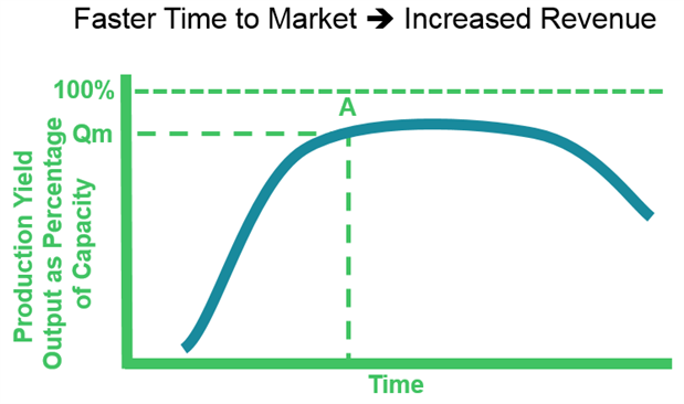

When running a race the homestretch refers to an area between the last turn and the winning post.  It can also refer to the last part of a product design project or a new production release campaign.  In each case, participants within the homestretch are often challenged to dig deep within themselves to overcome mental and physical barriers that stand between them and the finish line.
In this series of articles, we take a closer look at a few of the most frequently overlooked areas of new design starts. During the product design cycle if you overlook areas such as MAC addressing, product serialization, or factory test the first product builds can get tripped up or plagued with last minute scrambles to put measures in place to handle them or risk an impact upon your time to market.  You might be wondering at this point:  “I am a design engineer, why does any of this matter?”  These subject areas matter because they are potential hurdles that can slip initial production schedules by days or even weeks if they are not thought about ahead of time.  If we look at the graph shown below we see an idealized production yield curve.
By following the blue line we can see how much product quantity our manufacturing facility will produce over the lifetime of our product before the final build is made.  Our product’s profitability is bounded by the area under the curve and our product obsolescence date is fixed, then it follows that the business folks will want to cause the ramp-up period to point A to occur as soon as possible so that the maximum amount of market share can be captured by having our product on the shelf to sell to waiting customers with money in hand.  By implementing a small amount of planning upfront, you can help avoid these last minute hurdles in the homestretch to production and help reach point A as quickly as possible.
This post is the first in a short series intended to help others avoid common pitfalls encountered when releasing new products to the assembly line.  On the first part of this series, I wanted to spend some time on a topic that is very near and dear to my heart as it is one of the first problems that I worked on as a design engineer coming out of school, assigning products unique MAC addresses!

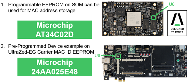

So where is this all going?  Well I have gotten questions from product engineers and designers over the years about how to read the MAC ID from an EEPROM and then utilize that MAC address from the software that they are running on their system. Thanks to a lot of help from my Avnet team, I am proud to announce that we have come up with an example design which shows design engineers how to read the EUI-48 from a pre-programmed EEPROM and configure the eth0 networking interface under Linux with the EUI as the unique MAC address.  This can be demonstrated on our UltraZed-EGUltraZed-EG PCIe development platform using the “UltraZed-EG IO Carrier Card - PetaLinux 2017.4 Enhanced BSP” found on this page of our community website:
http://avnet.me/ultrazed-reference-designs

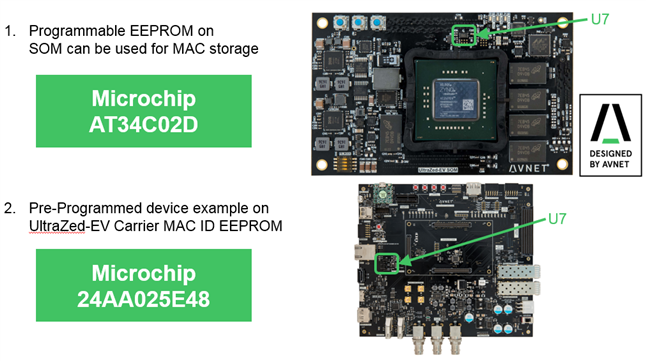

The PetaLinux BSP uses a startup script to scrape the MAC address out of EEPROM U6 on the PCIe Carrier and then call the ifconfig command to set the Ethernet interface HWADDR to match the MAC address read from the EEPROM.  This is an example of how to take advantage of a pre-programmed MAC EEPROM device using approach C from above.  A similar technique could also be used to read back the MAC address if the generic U8 EEPROM on the SOM were configured with a unique MAC address at build time using either approach A or B from above.
Similarly, the Avnet UltraZed-EVUltraZed-EV Starter Kit (AES-ZU7EV-1-SK-G) is an even more advanced Xilinx Zynq MPSoC development platform also uses this same approach of using these same pre-programmed MAC EEPROM devices.
