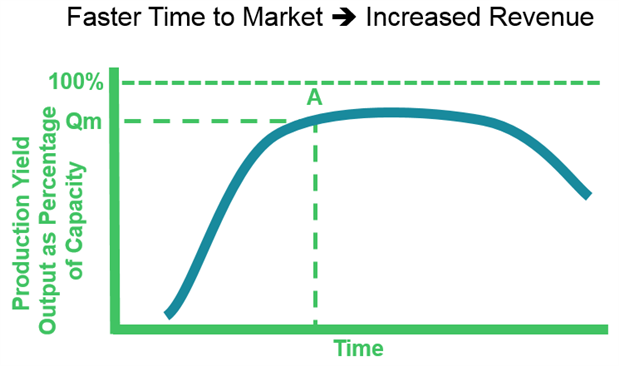

By following the blue line we can see how much product quantity our manufacturing facility will produce over the lifetime of our product before the final build is made.  Our product’s profitability is bounded by the area under the curve and our product obsolescence date is fixed, then it follows that the business folks will want to cause the ramp-up period to point A to occur as soon as possible so that the maximum amount of market share can be captured by having our product on the shelf to sell to waiting customers with money in hand.  By implementing a small amount of planning upfront, you can help avoid these last minute hurdles in the homestretch to production and help reach point A as quickly as possible.

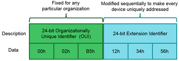

For anyone not familiar with MAC addresses or why they are so important, every device that communicates over an IEEE 802 compliant medium must have a unique MAC address*.  The IEEE maintains governance over the rules for issuance of MAC addresses and it generally breaks down to this:
When an organization wants to make new devices that will be connected up to a network they purchase a MAC address block where the IEEE assigns on OUI or an Oranizationally Unique Identifier to that entity.  This OUI consists of 3 octets that identify any device produced by that organization as having originated from that OEM or one of their subsidiaries, here you can see the OUI for Avnet is shown as the 00:02:B5 set of octets.  The second set of 3 octets are defined as the extension identifier and although the IEEE does not require that you assign these in sequential order, it is a strongly recommended practice since the IEEE requires application for certification that 95% of the assigned address space is consumed before being allowed to purchase another block of MAC addresses under a new OUI.

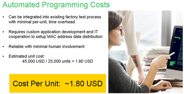

Consider this as a rough approximation of cost of doing MAC addresses yourself instead of buying a MAC EEPROM.  Take a Software Engineering salary for a half of a year of development/test/support: 45,000 USD and divide that by the total number of networked units benefiting from MAC and built over 5 years:  25,000 units.  Ignoring any equipment that the IT department or CM might bill to your engineering department, the amortized cost per unit is about 1.80 USD which goes down as you continue to build more volume of product.  Not cheap for lower volumes, but definitely less costly and much more reliable than the manual approach once you get past any roadblocks the IT department or CM throws up for you.

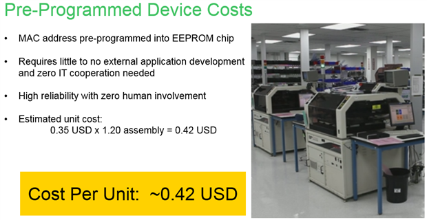

The best option for most manufacturing operations, unless you are talking extremely high volume, is to use pre-programmed parts. You can source specialized EEPROMs that have MAC-48, EUI-48, and EUI-64 identifiers, the identifiers are guaranteed to be unique, and the identifiers are pre-loaded at the silicon supplier for a fraction of what you might pay to do this manually.
This approach requires very little application development and the best part is that you don’t have to get your IT department involved for this!  Since there is no human intervening, the reliability of having unique MAC addresses on all your product is extremely high.
If you buy these components in quantity, of course the price gets a little bit better.  According to the Avnet/Newark/Farnell websites today 100+ piece pricing for Microchip 25AA025E48Microchip 25AA025E48 is just under 0.35 USD so it is still a very good deal compared to the other approaches above. Multiplying that times the cost adder to place a part on the PCB at your CM and you are still looking at the per-unit cost being less than 0.50 USD which is pretty good for most low-medium volume product runs.
Below is a picture of the inside of the Avnet Programming Center here in Chandler, Arizona where we have the ability to provide custom programming services, including serialized ID numbers, for non-volatile memory.  It is the largest programming center in North America and Avnet has similar programming centers from around the world that your customers can take advantage of for programming MAC addresses or other serialized information into memory devices.
