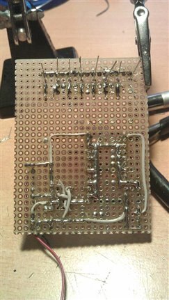

I knew I had no choice but to make my own PCB on a piece of perforated board. So I started wiring up and ended up with this mess :
And you guessed it, it DID NOT work! After a few hours of troubleshooting I did fix something but it turns out some LED's light up brighter than the others, then with the multimeter I figured that some outputs from the chip gave around 2.5 and some 3.5 volts maximum. And also the board was working at certain angles because the wires were loosely attached.

    jw0752 over 11 years ago in reply to matija.martinec +2
    Hi Matija, I always find that it is easier to run a piece of buss wire between the points that I want to connect and then solder it down to the pads on the board. I use a piece that is longer than needed…

    One comment about the soldering ...
    It appears that you may have had trouble getting the solder to stick to the board.
    This could be due to oxidation of the copper.
    You can use a simple eraser (for erasing pencil) to 'polish' the board, and therefore save yourself some frustration.

    Can I suggest that technique may be contributing to the issue .
    I'm involved with many schools in soldering a Christmas Tree, and one of the thing we run across is pupils applying the solder onto the iron, rather than to the junction of the board and component.
    This tends to burn off the flux needed to help the solder join the two parts together, and it seems this was the way they were taught.  ( ..... "un-learning" them is the first challenge).

    I am actually a lot experienced with soldering because we are doing it every week in school for 4 hours image, and I've been soldering for about 5-6 years now , but the only new experience I had right now was soldering these huge chunks of solder like paths (I was frustrated at first because I could not get the other solder to connect to the previous chunk)
    Hi Matija,
    I always find that it is easier to run a piece of buss wire between the points that I want to connect and then solder it down to the pads on the board. I use a piece that is longer than needed so I can hold it in place and then I clip off the extra after it is soldered into place. This eliminates the need to put so much solder onto the pads that they form a bridge. While not perfect it makes for a slightly neater job and also make a more solid connection.
