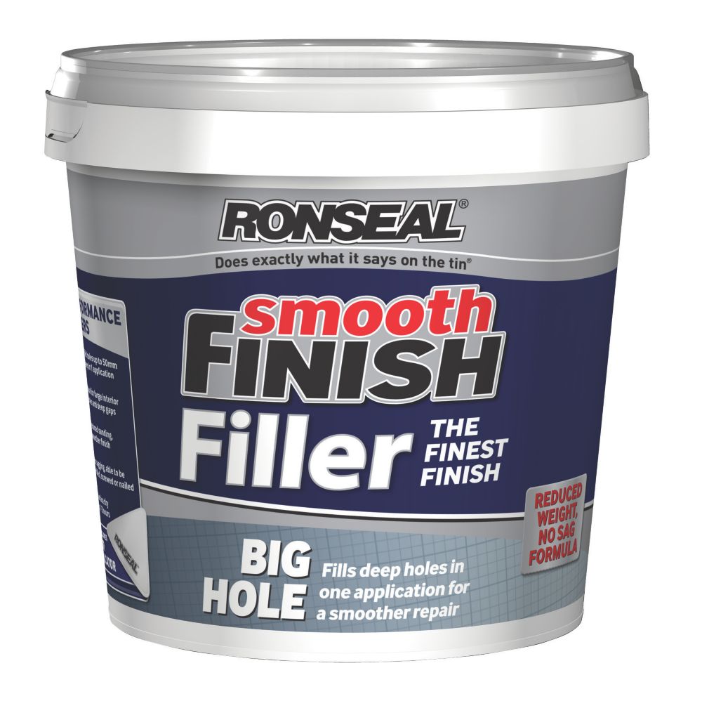

    I've also been doing some decorating today. There were loads of rawlplugs to remove because the previous owner thought it was OK to just wallpaper over them! I found that this hook and claw hammer do the best job for removing rawlplugs. Just screw in the hook (with a slightly undersized screw thread) and use a claw hammer to pull the plug out. I like the pliers for stubborn screws too. Note the grooves at the tip of the jaws which are aligned to make grabbing a screw head and twisting easy.
    When it come to filling, this is by far the best filler I've found. You can fill even large deep holes or cracks and it doesn't shrink. I has a nice grainy texture and it sands and paints easily.

    "...You can fill even large deep holes or cracks and it doesn't shrink..."
    And for really deep holes, place the plastic tub in the hole first, before applying the filler...  image
