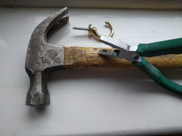

    I've also been doing some decorating today. There were loads of rawlplugs to remove because the previous owner thought it was OK to just wallpaper over them! I found that this hook and claw hammer do the best job for removing rawlplugs. Just screw in the hook (with a slightly undersized screw thread) and use a claw hammer to pull the plug out. I like the pliers for stubborn screws too. Note the grooves at the tip of the jaws which are aligned to make grabbing a screw head and twisting easy.

    dubbie over 6 years ago in reply to Fred27
    Fred,
    I thought of using a claw hammer to rip the screw out but I thought that would probably make more dents where the hammer had rested on the plaster so I never tried it.
