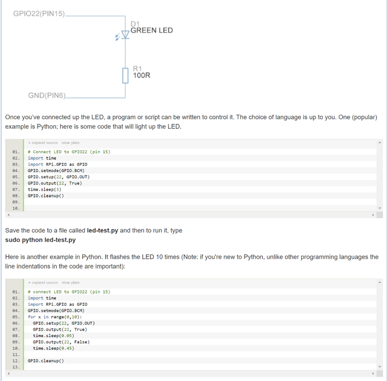

    Hi Dubbie,
    I know this isn't answering your specific question, but I was wondering if you have access to a Pi. If so, it's a very nice way to get familiar with I/O with Python, because you've the got access to normal Python, plus any libraries you want/need.
    To do input/output, some library is needed with the Pi. A popular one is gpiozero (although personally I don't like it, it's tutorials use a way that totally abstracts away physical I/O and replaces with pre-created classes for specific components. For example, there's an LED class and so on).
    An alternative easier-to-understand I/O library just provides I/O and nothing else - that's RPi.GPIO library, and using it is similar to using a microcontroller, in that a value is set to define input or output mode, and then True or False is set to turn an output on or off.
    There's an example pasted below, taken from Raspberry Pi GPIO Explained
    For Arduino, I think today most examples will still be in Arduino language (i.e. C pretty much) which is no bad thing, because C is used with nearly all microcontrollers, so still worth learning that too. Again, sorry for not directly answering your question, I've never used Python on an Arduino, perhaps I'm missing out.
