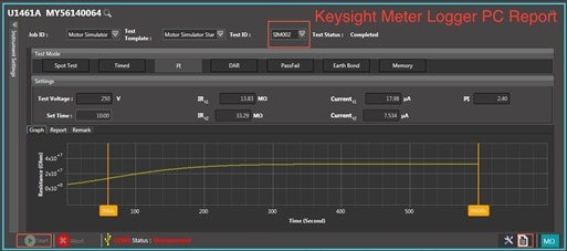

Keysight had some reasonable reports that I could produce by either linking the  U1461AU1461A to a laptop using the USB adapter, or via a wireless link to an iPad. Both produced similar reports as seen below on the left for the PC Logger Software and on the right for an iPad Insulation Test Report. Ideally I would have liked to have been able to export the data out to Excel to allow comparison to be made back to a baseline insulation resistance plot but I never got round to figuring out if I could do this.

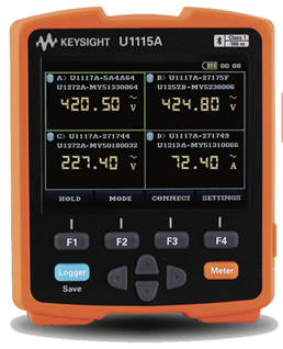

I purchased the Keysight  U1461AU1461A over 18 months ago now to use as an alternative to the Fluke 1555C insulation tester when testing out generator rotors. I also had the intention of using it for RSO winding resistance and impedance measurements where I need two multimeters to record the current and voltage at the same time. The longer term intention was to purchase the  U1115AU1115A logging module to simultaneously record the voltage and current to improve accuracy during the test and the quality of the report to issue to the site. I never got this far due to the issue I encountered

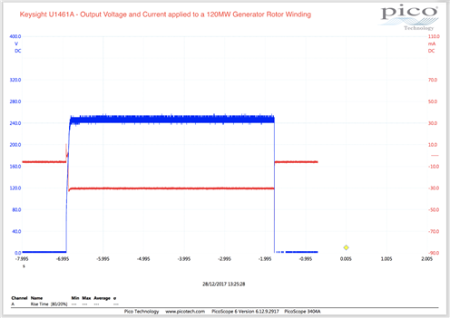

To try and gather some more information on a potential cause of this error, I hooked up one channel of an oscilloscope via a high voltage probe to measure the voltage applied to the rotor and then a differential probe to the second channel on the oscilloscope via a shirt resistor in series with the rotor winding to measure the current applied. The video of these tests is below in two parts, first part is the voltage and current, lasting three minutes and then the second part is the voltage only and lasts two minutes.
I had issues with recording the current, for some reason the polarity would always go negative despite reversing connections through the shunt, which didn't change the polarity and then on the differential probe, which had no effect either. The second issue is that the insulation value recorded on the instruments was steady at around 2MOhms, so I assume that the input impedance of the differential probe was affecting the overall test circuit.
Despite these issues the only difference obvious at the time was the faster application of the test voltage when using the Keysight  U1461A.U1461A. However both the voltage and the current from both instruments appeared steady on the oscilloscope screen through out the tests.
