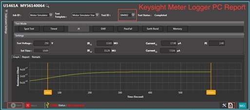

Keysight had some reasonable reports that I could produce by either linking the  U1461AU1461A to a laptop using the USB adapter, or via a wireless link to an iPad. Both produced similar reports as seen below on the left for the PC Logger Software and on the right for an iPad Insulation Test Report. Ideally I would have liked to have been able to export the data out to Excel to allow comparison to be made back to a baseline insulation resistance plot but I never got round to figuring out if I could do this.
