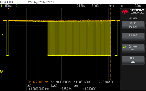

After the 'mark after break' comes the data payload. This is comprised of a start code followed by up to 512 channel data frames. In this case around 29.4ms.
After the channel data comes the 'mark after last channel' at around 1.9ms which then is followed by the 'break' of the next packet.

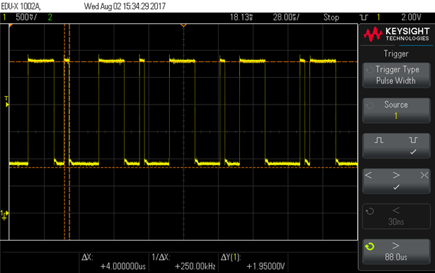

First low pulse is the start bit, followed by bits 0-7 alternating, followed by 2 high stop bits which merge into the 'mark between frame' idle time.
(In this case bits 0, 2, 4 and 6 are set, 1 + 4 + 16 + 64 = 85)
Here are the first 4 channels showing data values of 2, 4, 16 and 64. The width of each bit is 4μs as expected.

After the last channel data frame is the 'mark after last channel' shown here as around 1.98ms. Once again this is optional and the last channel data frame stop bit can be followed immediately by the start of packet 'break'.
