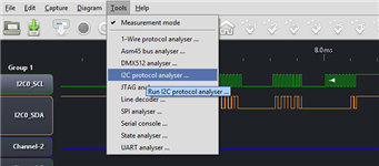

Connect your signals to the logic analyzer. For my i2c probing, I've connected ground to ground, SCL to A0 and SDA to A1
Then set up the sampling:
With the above settings, we'll sample at 200 MHz, triggering on a low of the i2c clock.
Here's the resulting sampling signal view:

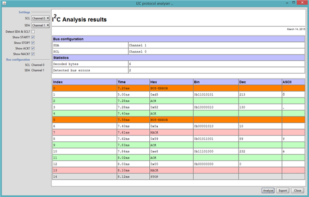

Once you're at this stage, you can use the i2c protocol analyzer to view the data and annotate your signal.

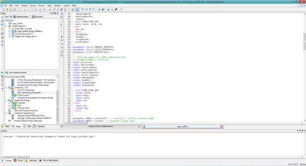

Just for kicks I'm also showing the Xilinx ISE. I haven't written any of the verilog (I'm only capable of writing some basic VHDL).
