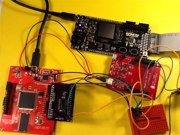

The bare minimum to start is one of the Papilio boards and a computer with USB port that can run Java.
With that alone you can start probing 3.3 V digital signals. So don't connect it directly to your Arduino UNO. The Arduino's signals are 5 V and the Xilinx Spartan doesn't like that.
I am using a Papilio Pro with a Xilinx Spartan 6LX FPGA. There's also a port available for the Papilio One with a Spartan 3E.
If you want to probe 5V signals, you'll need a level translator. Gadget Factory has a few buffer wings (the Papilio lingo for shield).
The Gadget Factory wing designs are open source. I've made my own based on their design. More on that later.

Connect your signals to the logic analyzer. For my i2c probing, I've connected ground to ground, SCL to A0 and SDA to A1

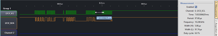

Then set up the sampling:
With the above settings, we'll sample at 200 MHz, triggering on a low of the i2c clock.

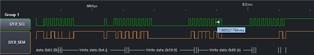

Here's the resulting sampling signal view:

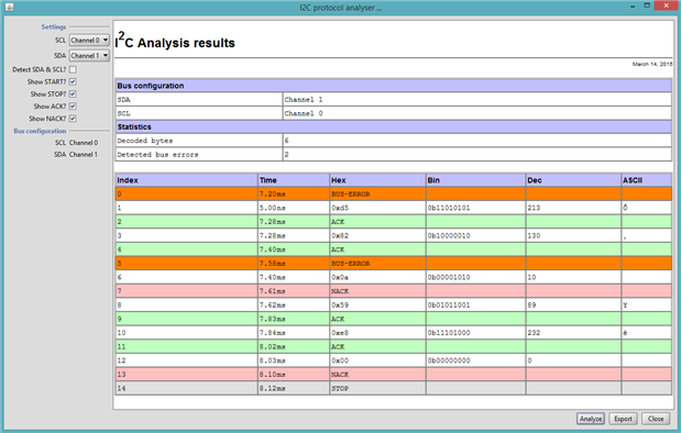

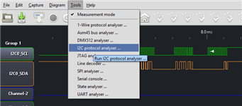

Once you're at this stage, you can use the i2c protocol analyzer to view the data and annotate your signal.

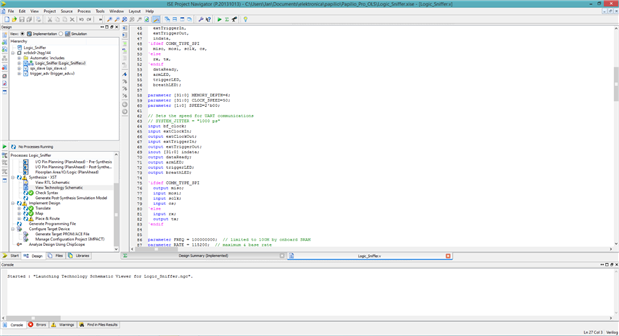

Just for kicks I'm also showing the Xilinx ISE. I haven't written any of the verilog (I'm only capable of writing some basic VHDL).
