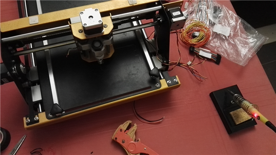

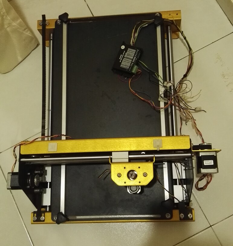

i brought back this machine from ex-company 18 months ago. at that time, they allowed us to bring back to-be-disposed item from company.
i found this machine which i believe it was x-y plotter/cutter prototype.
mechanical structure still in good condition.

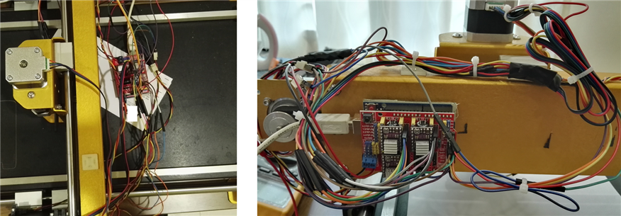

wiring is a mess. missing motor and motor driver. i dont know if it is functional.

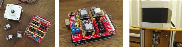

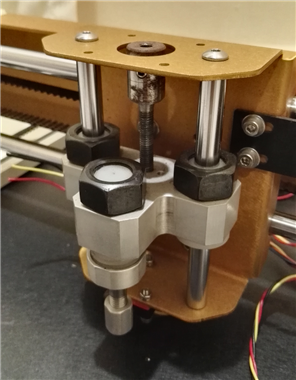

vertical axis motor missing. looks like a nema17 stepper motor.

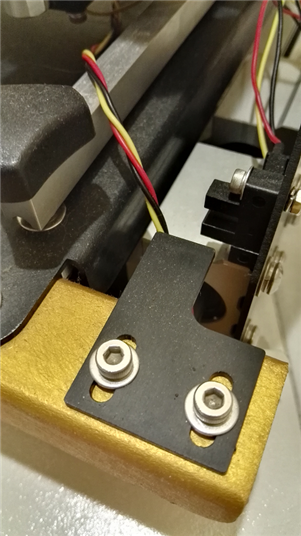

limit sensor still in place

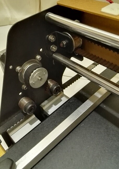

the machine uses timing belt, not lead screw for x-y motion.
i guess this might be the reason why they threw it.
i feel the machine might suffer from under power motor or low precision problem.
my plan is to revive this bot as a x-y laser plotter machine.
first of all, i am going to test if this machine still functional.
ordered a nema17 motor, arduino cnc v3 shield and few pcs drv8825.
will test once the components arrive.
Parts arrived,  assembled and install on the machine.
some wiring job. the wiring still is a mess. got to find some time later to clean it up. my priority still to get the machine run for the first time.

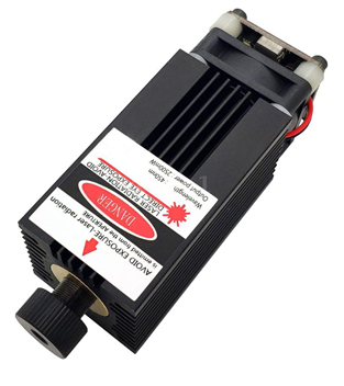

ordered a 2500mw laser head, havent received. i test only x-y movement with laserGRBL UI. https://lasergrbl.com/en/.

waiting for this laser head. cant wait to have my first laser engraved wood by next week.

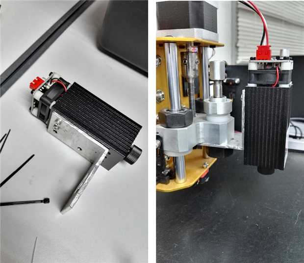

I got the laser head arrive yesterday.
make a not so nice looking bracket to mount it on the machine.
cant wait to test it out. power is on, connection is on, protection glass is on.

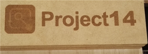

finally, i get the printing done.
driver overheat problem - reduce current limit rating to slightly higher than what motor needs.
laser power is not too strong after tested with medium density fibreboard. i should have bought 10w laserhead. can get faster printing speed with that.
