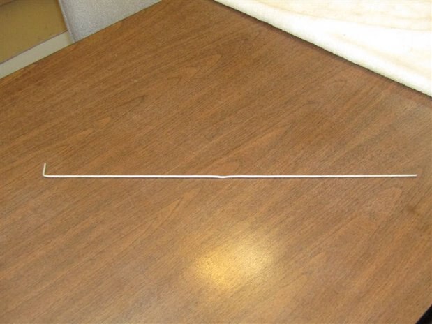

    Hi Dubbie,
    I got curious and decided to run my own experiment with some 3.16 mm ( 1/8 inch ) aluminum ground wire that I had in the shop. Here is the initial shape of the wire:

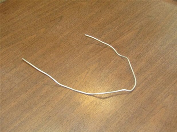

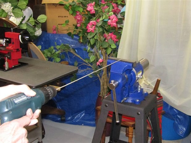

    I put the wire in the vise and drill and pulled as tight as I could and it looked like this. At this stage there would still be quite a bit of bend in the wire if I hadn't twisted it.

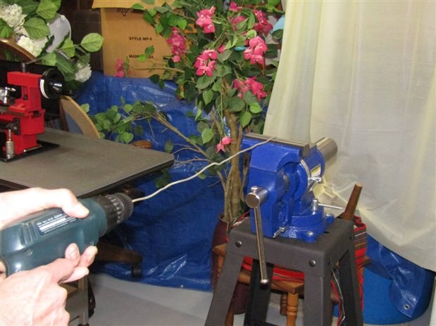

    I began to twist the wire with the drill and I watched the tight bend near the center of the wire as I hoped it would totally disappear.
    As you can see things did get better but the tight bend did not disappear completely. I put a lot more twists per meter of length into this wire than I usually have to. I am not sure if it was the aluminum or just the tightness of the bend I was hoping to eliminate. At some point it is prudent to stop twisting as twisting puts the same weakness into the wire that bending it back and forth would. The twisting is a compromise whereby we sacrifice some strength for the straightness. In most cases the loss of strength is inconsequential compared to the improved appearance of the finished project. If you continue the twisting, the wire will eventually twist off at its weakest point which is usually right at the point it is held in the vice or the point where it enters the drill chuck.
    Here is the finished wire:
    I usually work with 10, 12, and 14 Gauge copper and I straighten 3 to 4 meter lengths. Usually there are no tight bends just a curve left from the coiled condition of the original packaging of the wire. In these circumstances the wire straightens almost perfectly with only minimal twisting involved.
