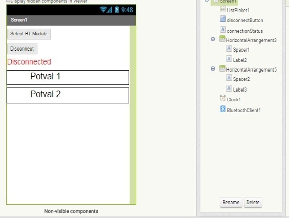

Firstly, I have simplified, and modified the Android display. I have also added a Bluetooth disconnect function block to the app.
Ignoring the Bluetooth connection and disconnection blocks, which have been show elsewhere, my data processing block looks like this:
I have used a variable, rather than labels, for the data decoding. The variable is defined, globally, outside of the main code block and initialised to 0.
Once the incoming data string has been captured  to the variable "incomingData", it is tested to make sure it is numeric - it will be, most of the time, but there are sometimes glitches in the serial comms or the Bluetooth, which can result in run-time errors.
Assuming that "incomingData"  is numeric, it is tested for size: less than 1024 is displayed in Label2; between 2000 and 3023, subtract 2000 and the result is dispalyed in Label3.
Leaving in the test for <= 3023 allows for easy expansion of this solution to more than 2 data items

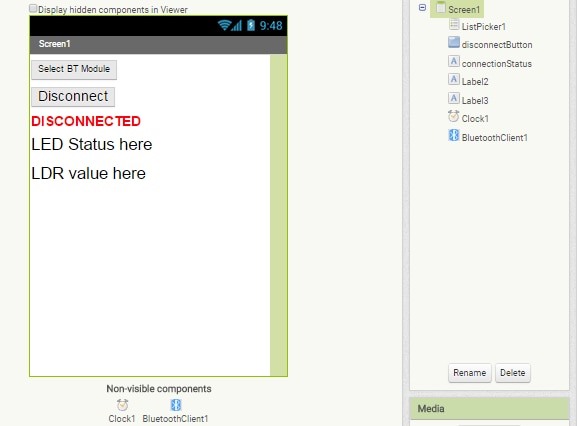

Here is the screen design from App inventor and below that are the code blocks  to process the data strings:
Again, the incoming data string is captured to the variable, which is initialised to "0", but this time we are handling it as text and so there is no need to test to see if it is a number - indeed, it isn't!!
The data string is first tested to see if it contains the sub-string "LED". If so, it is displayed in Label2 and processing ceases. If "LED" is NOT found (else if), then the data string is tested for "LDR", and if found, displayed in Label3. Processing then ceases.
