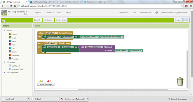

If we click on the Blocks Tab and then click on the ListPicker1 component on the left hand side of the screen. A scrollable list of code blocks relevant to the ListPicker1 appears. Click  on “When ListPicker1 BeforePicking” and it will be placed onto the Blocks screen area.
We can now select further sub-Blocks to create the first full code Block, below..
This allows List Picker1 to display the available (already paired) Bluetooth devices: - This next code block has been corrected 18 January 2015
