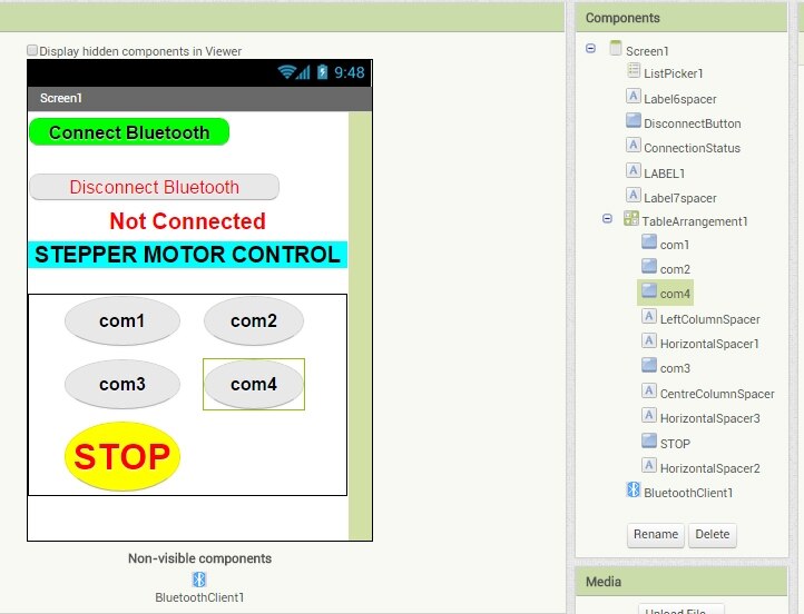

EXAMPLE 1 - generating fixed command strings
The screen appearance of the Android app needed to send out the fixed command strings is shown below:image
A few observations on the appearance of the Android screen:
  1. In order to space the buttons neatly, a table arrangement of 4 columns and 5 rows has been used.
  2. The buttons are placed in columns 2 and 4, rows 1,3 and 5. Blank label separators are used in columns 1 and 3 and rows 2 and 4 to achieve the desired layout.

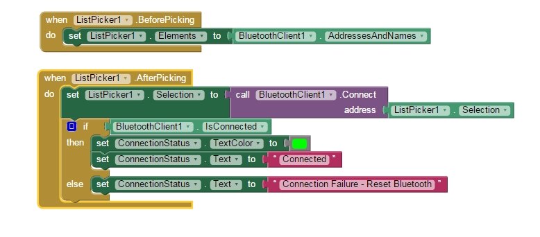

The code blocks necessary to achieve the Bluetooth connection are similar to previous posts. However, a deliberate test for a successful connection has been added, with an appropriate message if the connection failed.

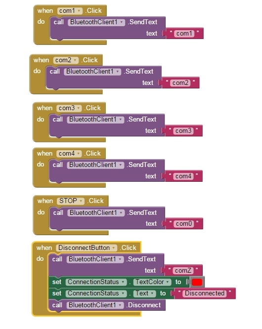

The code blocks necessary to transmit the fixed command strings are quite simple:image
An additional command string, "comZ" is transmitted if the Bluetooth connection is deliberately disconnected.

The interpretation of the command strings is as follows:
  1. com0 = STOP immediately and disable the motor drive pins
  2. com1 = Move/Step the number of steps defined by a variable in the sketch, CLOCKWISE
  3. com2 = Move/Step the number of steps defined by a variable in the sketch, ANTI-CLOCKWISE
  4. com3 = Run at a speed defined by a variable in the sketch, CLOCKWISE
  5. com4 = Run at a speed defined by a variable in the sketch, ANTI-CLOCKWISE
  6. comZ = STOP immediately and disable the motor drive pins - Bluetooth has been disconnected by the Android

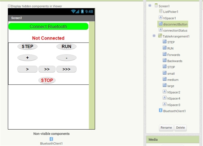

EXAMPLE 2 - generating variable command strings
The screen appearance of the Android app for this second example is shown here:
A few observations about the design:
  1. The Disconnect button is not visible on the screen UNTIL the Bluetooth client has been connected - demonstrating an additional feature of AppInventor.
  2. As in Example 1, the command generating buttons and the STOP button are arranged in a table, containing 5 columns and 7 rows. Again, empty  labels are used to space the buttons neatly.
  3. It is difficult to choose specific values for the speed/number of steps buttons because of the disparity in values - the 28BYJ-48 has a nominal 4096 steps per revolution, so although a speed of 500 is quite fast for this motor, 500 steps doesn't move it much. For this reason, the 3 buttons labelled      " >" ,  ">>" ," >>>" actually transmit the characters "1" , "2" , "3"  and their precise meaning is decided in the Arduino sketch.
  4. The STOP button transmits a valid command string with "0" as the the 3rd parameter.

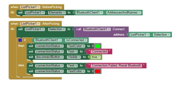

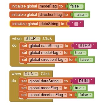

Here are the code blocks to establish the Bluetooth connection:
Note the additional instruction set disconnectButton.Visible to true This will only be executed if the Bluetooth client connects successfully.
The code blocks defining the flags and variables and to handle the mode buttons (STEP and RUN) are shown next:
The logic for the STEP and RUN buttons is the same, but with  dataString initialised appropriately. There is no need to check any flags before setting up dataString. However, just in case the buttons have been pressed out of sequence, there is a need to reset directionFlag.

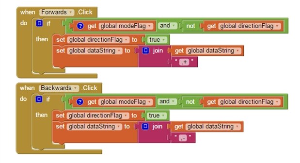

The code blocks to handle the direction parameter are shown below:
With the direction buttons it is necessary to prevent button presses out of sequence from corrupting the dataString. We need to test both the modeFlag and the directionFlag, to make sure we don't press a direction button a second time.

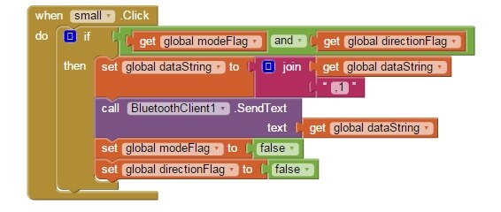

In this next code block - only one of 3 almost identical blocks is shown here - we see how the size buttons are handled:
As can be seen, the size button is ignored unless both the modeFlag and the directionFlag are set. After the size character has been concatenated onto the dataString, the dataString is sent out to the Bluetooth device and on to the Arduino
