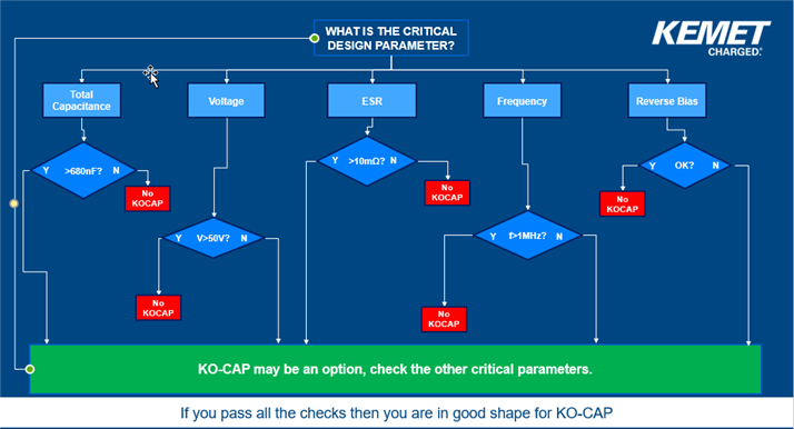

I am not delusional, I was (am) an engineer too and selling me on tantalum when I’m looking for MLCCs isn’t exactly the way to my heart. But, as engineers, solving problems is what we do and that means doing things we haven’t previously considered. As with anything else in engineering, making the decision to go to KO-CAP from MLCC is just a matter of managing tradeoffs. There is a slew of things that must be considered when making that decision. The critical design parameters that must be considered when attempting to make the change are; capacitance, voltage, ESR, frequency, leakage current, size, and qualifications. The flow chart below serves as a guide to making that decision when considering each of those critical design parameters. We are going to look at it from the standpoint that you’re trying your best to get as close as possible to the characteristics of your ceramic capacitor.
Capacitance
KO-CAPs tend to have more capacitance than a similarly sized ceramic capacitor. They don’t come in values smaller than 680nF. So, if your total capacitance is less than that, KO-CAP is not a suitable option. When it comes to capacitance, it is usually a very strong value proposition to replace a bank of MLCCs with one or two KO-CAPs.
Voltage
In KO-CAP or any tantalum-based capacitor for that matter, the dielectric layer is very thin. A typical value is about 20nm. Having such a thin dielectric gives you a large amount of capacitance, but it also has the effect of limiting your voltage. A “high voltage” KO-CAP would be anything more than 35V. In general, if your operating voltage is more than 50V, KO-CAP is not a suitable option.
ESR
Ceramic capacitors, in a general sense, have lower ESR than an equivalent KO-CAP counterpart. That is not to say that there aren’t some very low ESR KO-CAPs. Some even go as low as 8mΩ, but a typical cutoff of 10mΩ is adequate. If you need ESR less than that, then KO-CAPs may not be a suitable option.
Frequency
What you have to watch out for when considering frequency characteristics of KO-CAP is the self-resonant frequency. You generally want to operate capacitors below this point. It isn’t always the case, but if your switching frequency goes beyond 1MHz, then you may be approaching the limits.
Reverse Bias
KO-CAPs are polar devices, as such, they can not take reverse bias voltage. If the capacitor is placed in a location in which reverse bias is possible or needs to be tolerated, KO-CAPs are not suitable.

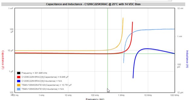

Input Side
C1, C2, C3, and C10 are my input side capacitors. They are 2.2uF 50V 1206 X7Rs. There isn’t a drop-in replacement for the ceramics, but I can take the total 8.8uF capacitance and replace the 4 ceramics with one 10uF 35V KO-CAP. It is more than the original capacitance we need, but it is still within the required range for this regulator. ESR, Leakage, and frequency are not of concern on the input side, as long as the input isn’t direct battery voltage. Our simulation tool, K-SIM, show their side by side comparison.

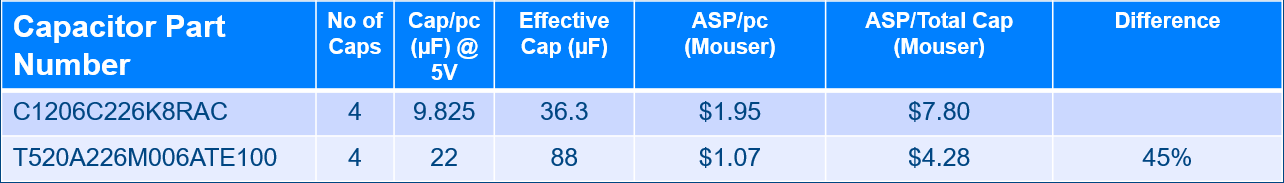

Yes, I hear your concern, “what’s this going to cost me?” Well, let’s do the math. The total cost of the 4 MLCCs is $4.16. Replacing those 4 with one KO-CAP save about a bit over a dollar.

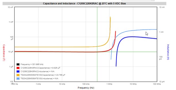

Output Side
On the output side we have C6, C7, C9, and C11; 22uF 10V X7R 1206s. In this case, we are lucky, there is a drop-in replacement of that in KO-CAP. It is 6.3V but more than the output voltage range. In this case the KO-CAP ESR is higher than the ceramic equivalents, but still within the design spec. The switching frequency of the circuit is 300kHz and the SRF of my replacement is around 1MHz, so I am good there.Money-wise, we have a similar story on the output side. That MLCC is nearly $2! Yeah, I know it is a very expensive cap, but you can’t even get it anyway, so it is a moot point. The KO-CAP replacement is just over a dollar. Saving you a whopping 45%.image
