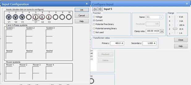

To use them I need to tell the Enerlyzer software which input to look at and what the input range and ratio will be. This is done from the input configuration screen accessed from the main Enerlyzer screen.
Double clicking on one of the 10 inputs at the bottom will bring up the configuration scheme, on th elf in the picture below, that allows the inputs to be assigned into a 3 phase power system, I have chosen not to do this. A further extension to this screen, seen on the right, allows the parameters to be entered for an individual input.
Input 1 has been configured as a voltage input in the function setting, It is then given the name of V1, set to a range of 600V and in the transformer ratio section, the 132kV to 110V ratio is entered. This is equivalent to the line values of 76.2kV and 63.5V. Inputs 2 and 3 are then configured the same but given the names of V2 and V3 respectively.
Then it is the turn of the current inputs. These had to be entered into Inputs 5, 6 and 7 as the inputs on the Omicron are physically connected into pairs on the common line. Therefore Input 4 can not be used for a input as its common is shorted to the voltage on Input 3.
The current input is configured in a similar manner to the voltage, but with the added option for the clamp ratio, which is set to the ratio of the 5A current clamps I am using. A clamp is a 5A, I set the range up to 10A, to allow for the transformer in rush. The primary ratio of 400:1A is then finally entered to match the CT ratio out on the plant.

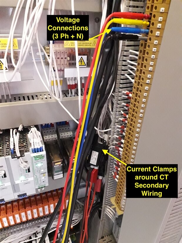

Picking up voltage signals is relatively easy, as it just requires a connection onto the relative terminal. Current, though has to be picked up in series, so can be a little more troublesome. Relay manufacturers have though of this and provide test blocks / terminals to facilitate with connecting in series for current measurements. The particular system I am use to is the MIDOS MMLG from GEC.
The picture above is from the GE manual, that shows the test block on the left, that would be hard wired into the panel. This contains multiple spring loaded contacts that are wired into the CT circuits. The MMLB01 test block, on the right, contains standard 4mm breakout connections connected to a set of contacts within the MMLB01 that separate the spring loaded contacts in the MMLG01 as the MMLB01 is inserted into it. This provides a make before break connection system that prevents CT secondaries from being open-circuited. To achieve this all connections into the test apparatus, along with shorting links for any unused CT circuits must be made into the MMLB01 block prior to inserting it into the MMLG01.
Unfortunately these systems are not always available, or have all the right signals through them. So to overcome this, I have a small set of 5A current clamps from LEM.
Front of protection panel with Omicron to the side
Wiring run from Omicron into panel
VT Connections onto Terminal rail and CT connections around cables
With these connections made, it is just a matter of coordinating the manual triggering of the test set in conjunction with the closure of the 132kV breaker. The Omicron will record the data ready for us to analyse.
