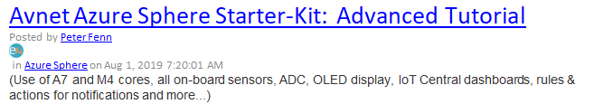

  • Well, I used these projects on element14 from peterfenn
  • They access the Light Sensor
    • one using the A7 and A4 cores the other using a new feature of the OS version 19.9
  • I used these code samples to Send the Light Sensor data  to Azure IoT central and used the Email Alert rule to Send the email to tell me when the light was on.
  • There was no code to write for this project. All the functionality I needed to track the Light Sensor Telemetry data was already written. These are excellent starting points to reading the On-board kit sensors,click boards and an optional OLED Display.

Avnet's Azure Sphere Starter-Kit (Out of Box Demo) Part 1 of 3
Posted by bwilless image in Azure Sphere on Apr 24, 2019 6:58:25 AM
These 3 "Out-of-Box demo" three-part blog series (by Brian Willess) is an excellent starting point for you to use the on-board sensors to gather Telemetry data.
This "advanced tutorial" is partitioned into two sections, enabling it to be worked on in two sessions:
• 1st section focus is on configuring, building and running the M4 and A7 embedded applications (and viewing local output from these applications)
• 2nd section walks the user through the capabilities and expansion options of the Azure IoT Central cloud application that the A7 embedded application is connected to
It consolidates what was covered in Part 1 and Part 3 of the "Out-of-Box demo" three-part blog series (by Brian Willess) but adds shortcuts and a number of new capabilities to the overall application (see detail below).
This tutorial is intended to be used standalone (no dependency on previous material) but it is recommended that at minimum Part 1 of the earlier blog series be reviewed before starting.
I've COMPLETED THIS ONE AND IT IS somewhat WORKING NOW
I'll be able to use what I learned to  complete code steps 2 and 3 mentioned above.
But I was unable to CMake the A4 project for some reason.
