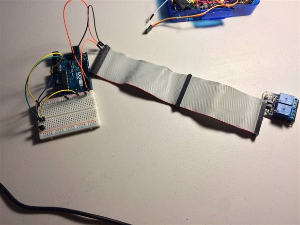

So I have been looking around online for ways to use the MagiQuest wand at home, but have found very few solutions. I decided to make my own. Using the Arduino IR library I got some raw values from the wand using a old IR sensor from a VCR and then took those values and converted them from decimal to hex value using an online calculator. I just googled it and found one. Then made up some code that detected when a certain IR code was detected to activate my relay board and turn some lights off and on. My hook up is the IR sensor is on a breadboard connected to the Arduino, then I have jumper cabled hooked into a IDE cable because I only have male to male jumpers, then the IDE cable hooks into the relay board activating the relays. Right now I have 3 wands that the Arduino can interact with I can add more though.

    I had to cut some parts where the Arduino wouldn't respond. A lot of signals get sent. Sometimes it receives and decodes the wrong one.
