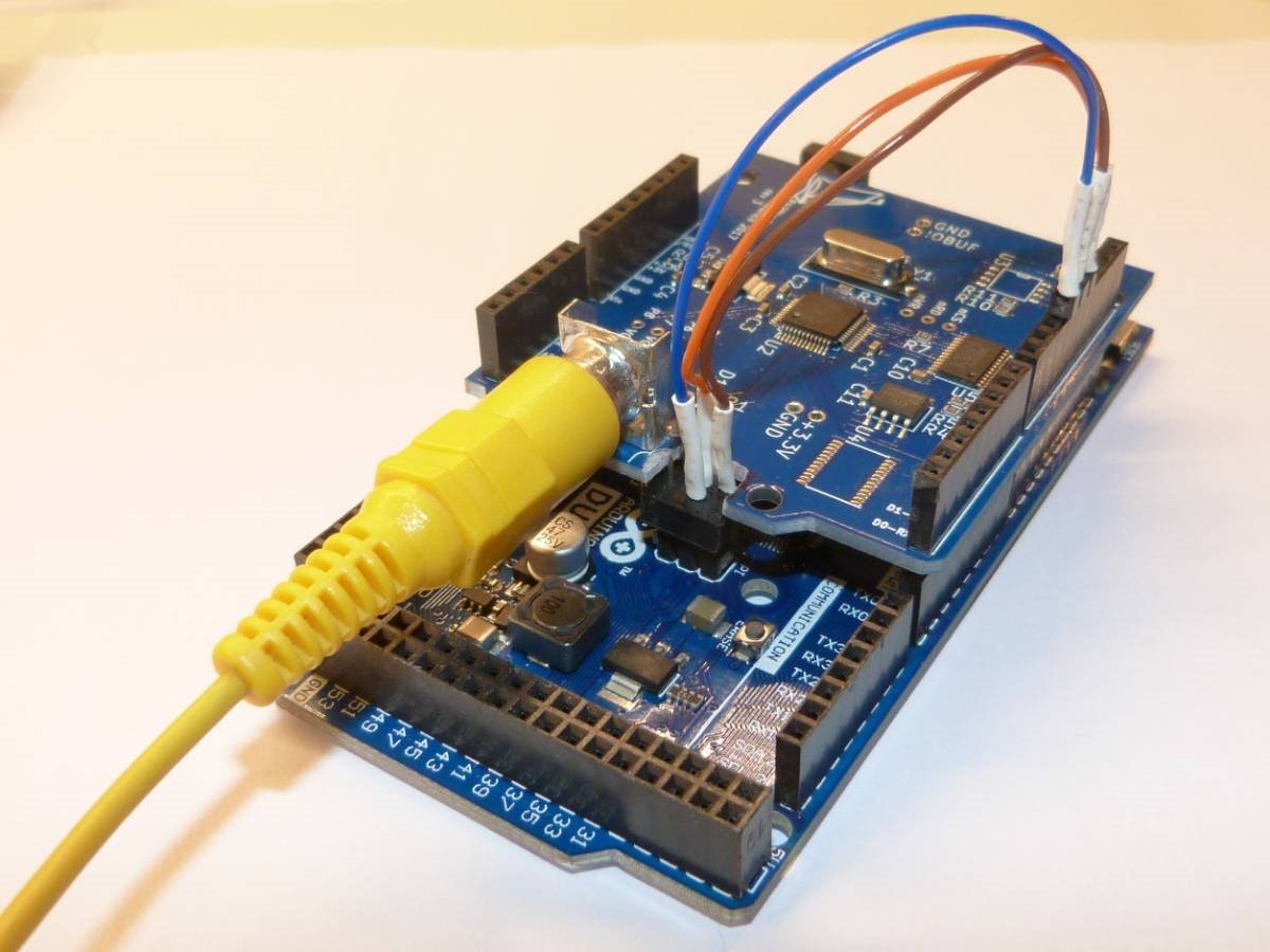

Using the board with an Arduino MEGA or DUE requires a special cable to connect the SPI interface and a few extra commands to disable some pins on the controller. Another option would be to use a SPI soft core and map the same SPI pins as the UNO. I have not tried it yet.
To use my Video Display shield (and any other UNO shield that wants to talk SPI) with my MEGA clone, this is what I did:
Connect the SPI communication signals through jumper wires to the shield.
SCK:  Mega pin 52  -> Uno shield pin 13 - orange wire
MOSI: Mega pin 51  -> Uno shield pin 12 - brown wire
MISO: Mega pin 50  -> Uno shield pin 11 - blue wire
The slave select pin 53 does not need to be wired, as it is mapped as a normal GPIO in a normal Uno sketch. The picture for the pin numbers 50-51 on the Mega connector is misleading due to the parallax.
(The RCA connector is not in a ideal location for the wire jumpers. Here is a reason for another spin).
It is also possible to cut a piece of the PCB to get access to the SPI header.
Make pins 11 to 13 on the Mega inputs or tri-stated outputs.
Add the define somewhere in the header file for the shield or at the beginning of the sketch
#define MEGA
Add the code to disable the pins that are used by Uno for SPI in the setup() function
#ifdef MEGA
pinMode(11, INPUT);
pinMode(12, INPUT);
pinMode(13, INPUT);
#endif
This was all I needed to do and the MEGA was happily configuring the Video Display shield and outputting the test patterns. Connecting to the DUE is similar but tricky because the DUE SPI connector is sitting under the shield. To get better access I would raise the shield with an extra set of headers.
