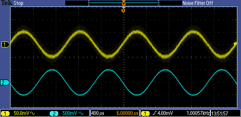

and here are the waveforms I get with a 100mV pk/pk sine wave going in
