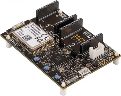

The Microsoft solution uses a Seed Development Board but I wanted to use an Avnet Sphere MT3620 Starter KitAvnet Sphere MT3620 Starter Kit (AvnetSK) so it was necessary to port the Microsoft Sample. This required addressing the following differences:
  1. The Seed Development Board has more LED’s (that the sample uses) than is available on the AvnetSK.  So the code will be modified to alternately blink the LEDs between the Status Color and the User LED Color.
  2. To connect to the AvnetSK, I wanted to use the MikroE Click Board sockets that available.  While Click Socket #2 supports all UART interfaces (RX/TX/RTS/CTS), Socket #1 doesn't and I wanted to allow the use of either Socket.  To support both sockets, the hardware interface must be reduced to its minimum—RX/TX/GND; and it will also require modifying the nRF52 firmware to remove the hardware flow control requirment.

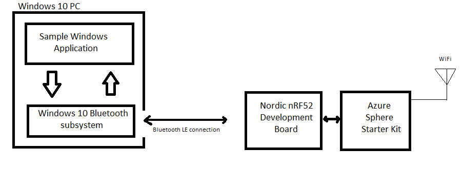

The following is a "big picture" view of the current solution:
The Microsoft Sample includes a basic Windows Application that uses the Windows Operating System to communicate with the Nordic nRF52 board.   In turn, the nRF52 board communicates with the Azure Sphere board via a UART, message exchanges between the Sphere Board and Windows Application demonstrate the remote management capabilities.  It is worth noting, that even though the Sphere SDK provides API's for numerous features, the current Sample solution only uses those that start with ‘Wifi’ (e.g., WifiConfig_ …).  It wouldn't be to difficult to extend the messaging to be inclusive of other API's if desired.

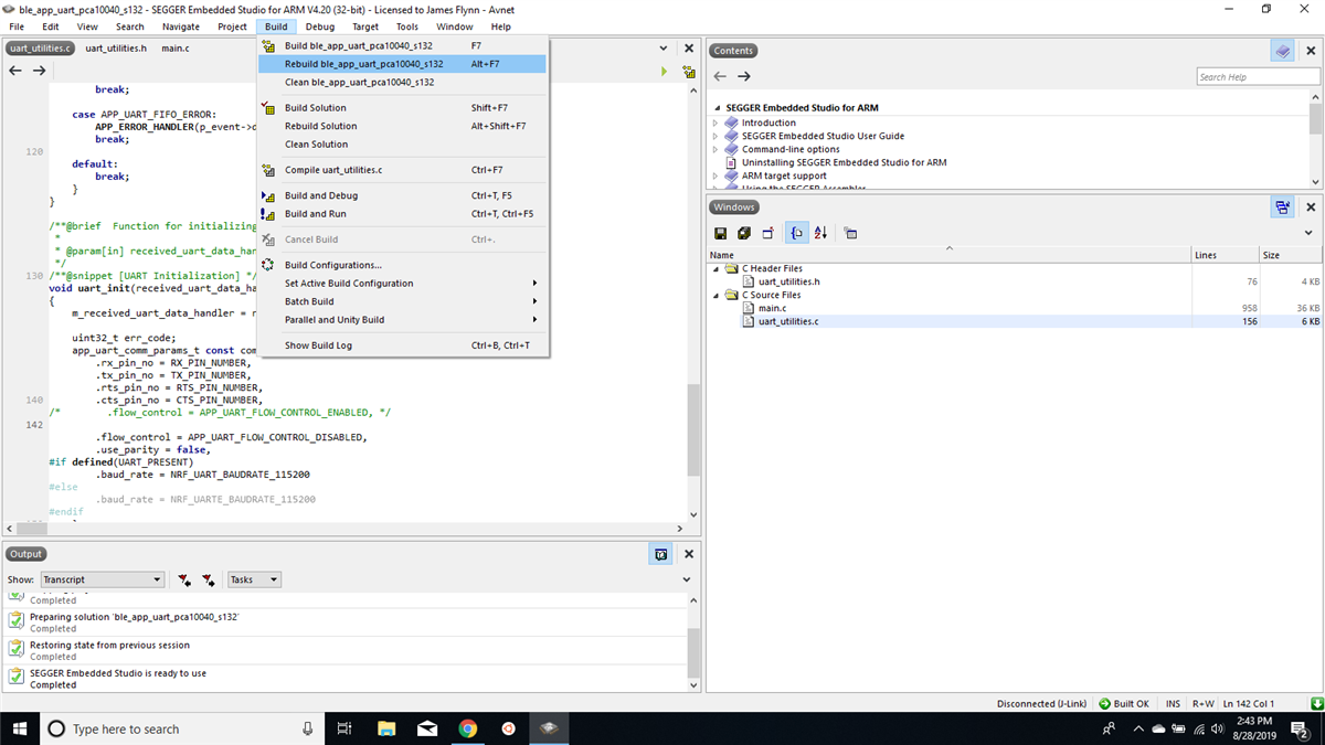

After changing the nRF52 source, rebuild the firmware, combine it with the SoftDevice firmware (that is provided in the Nordic SDK) and reload it onto the board. To accomplish these tasks, you must download the Segger embedded Studio, the Nordic NRF5 SDK, and the Nordic nRF command line tools:
1. Download and install the SEGGER Embedded Studio (use the 32-bit version, not the 64-bit version). You can obtain a license if you are developing code for the nRF52 (which we are).
2. Download and Install the Nordic NRF5 SDK V15.2.  Ensure you download v15.2 as newer releases are likely available but this is the version that was used for this sample code.
3. Download and Install the Nordic nRF5x Command Line Tools.  You need to this so you can have the mergehex tool which is used to combine the image you produce with the Softdevice hex file provided in the SDK.
After the SDK is installed, go to the embedded studio project file (WifiSetupAndDeviceControlViaBle\Nrf52App\pca10040\s132\ses\ble_app_uart_pca10040_s132.emProject) and set the SDK_ROOT variable to point to the root directory of your Nordic SDK install. Specifically, replace the words "CHANGE_THIS_TO_YOUR_NORDIC_SDK_PATH" with the correct path.  NOTE: make sure to use Linux style backslashes ('/') instead of the windows style ('\').
With the tools installed (and after modifying uart_utilities.c), open the emProject file in the Segger IDE and rebuild it (Alt+F7 for a full rebuild).

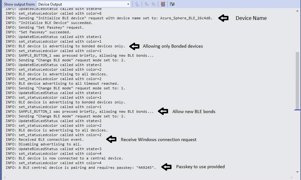

  3. Once downloaded and started the output window will reflect the status of the Sphere Board.  Initially, it will be advertising to connect, known BLE devices and the LED will be flashing blue.
Running the Azure Sphere Application
At this point, the AvnetSK will only connect to previously bonded devices.  For the initial connection however, it must allow connections to ANY BLE device.  To do this, we first need to obtain the device name which is generated and displayed in the Output window in Visual Studio during startup (the name will look something link Azure_Sphere_BLE_123456).  There are actually two steps that are necessary to run the Sample Application:

The sequence of events displayed in the Visual Studio Output windows will be similar to:
After you have entered the passkey, the nRF52 will pair with the Windows PC and you can use the Sample Windows App.

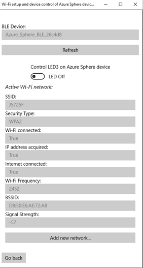

Connecting the Windows App to the AvnetSK
  1. Now that Windows and the nRF52/Sphere Board are connected, start up the Sample Windows App by compiling and running it (use the instruction contained in the Sample README.md).image

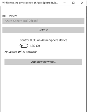

  2. After it starts, you can "Scan for devices"  and find your previously bonded Azure_Sphere_BLE_999999 device.  Select it and the App display will show that you either need to Add new network... or the details of the currently connected network.
    1. If no active WiFi network has been established (as shown), select "Add new network..." to perform a WiFi scan then Select the appropriate Network, enter the security key (if needed) and the Starter kit will be connected
  3. Details of the connected WiFi network will be presented in the Windows App
At this point, you are successfully connected to the WiFi network.
You can also use either the LED button in the Windows App  or Button B on the sphere Board to control the User LED (regardless of the WiFi connection status).  If the User LED is enabled, the LED will alternately flash WHITE and the WindowsApp button will be green.  Conversely, if it is disabled, the LED will not flash and the WindowsApp button will be WHITE,
