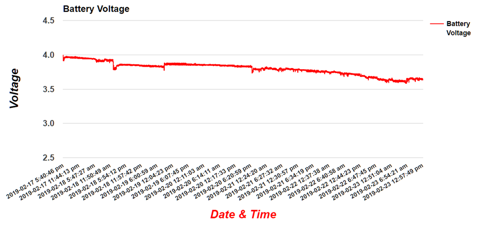

I then modified the sketch to reduce the drift in the sleep time which is evident in the chart from Long Term Test 2, repeated below:
I checked the battery voltage and was pleased to see that it still showed 3.74 V on my DMM. Rather than charge it, I decided to reconnect the Wemos d1 mini system and see how much longer the battery would last
When I terminated Long Term Test 2, the battery voltage, as monitored by the Wemos d1, was 3.64V. When I reconnected everything and restarted the sketch, the battery voltage as monitored by the Wemos was 3.8V.

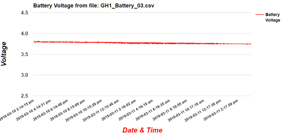

First Partial Test:
I terminated this test run after just over 25 hours, to allow for further correction of the sleep time. At the start of this partial run, the battery voltage, as measured by the Wemos A/D was about 3.8V and at the end it was about 3.75V.
One observation from this first partial test is that the battery voltage appears to be noisier during the night - when the temperature drops.

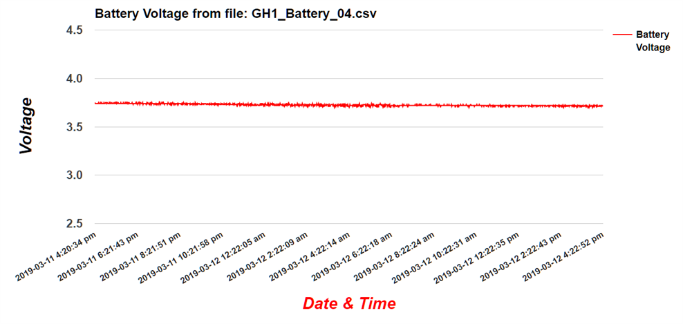

Second Partial Test
The battery voltage at the start of this run was about 3.75V and at the end of the run it was about 3.7V - this is over approximately 24 hours. Once again, the measured voltage seems to be noisier overnight - it was colder!
Now that the sleep time error is much less, it's possible to discern a variation of the error with ambient temperature.
I made a further adjustment to the sleep time, reconnected the battery and started another test, intending to run this one until the Wemos stopped working

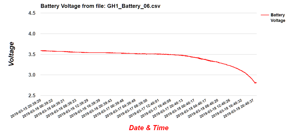

Fourth and Final Partial Test
And finally, the Wemos dies! The  final battery voltage, as measured by the Wemos A/D, was about 2.81V, after a further 3 days. This is a lot lowerr than the 3.2V stated in the Wemos data sheet.
In total, with interruptions, the battery lasted about 336 hours, or 14 days, far longer than originally predicted!

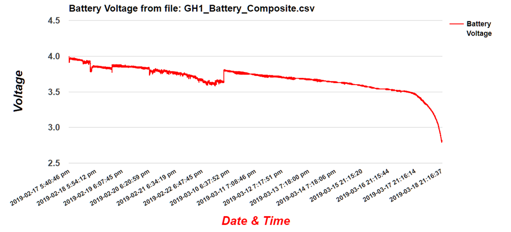

I have concatenated all the battery files together to show the whole discharge pattern - apologies for the first section, before I fitted the correct connector to the battery leads!
Composite Graph
The date/time axis has interruptions in it, but is set to display a value every 1440 readings. With +ve drift in the sleep time, this will be slightly more than 24 hours.
Conclusions
The 18650 Li-ion battery lasted far longer than I anticipated - a total of 14 days, with readings at 1 minute intervals. Increasing the interval between readings to 5 minutes would give a battery life of perhaps up to 70 days - plenty long enough for a remote, unattended device.
