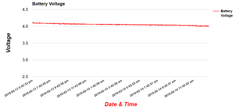

I left the Wemos running on battery overnight and here is the resultant chart:
We can easily estimate the battery voltage drop to be about 0.25V over about 18 hours or so. Not really good enough for a serious, remote monitoring device!

I modified the sketch to send all the data in a single POST command and reduced the sleep time correction factor from 10 seconds to 5 seconds. I also wrote a new php script to respond to the new POST command and write the temperatures and battery voltage to two different files on the server.
After correcting a few typos, I got the modified software working and here is the result:
The last reading taken before I switched off was at 1:27:54 pm.
This is a massive reduction in power consumption, the chart showing a drop of about 0.1V over a period of just under 20 hours. The datasheet for the battery shield quotes a Lithium battery voltage range of  3.3 to 4.2V. However, in this article:
https://arduinodiy.wordpress.com/2017/01/02/reviewing-the-wemos-battery-shield/ the author notes that his Wemos stopped working when the battery voltage had reached 3.56V
If we assume that the battery discharge will be linear down to 3.6V, , then it will take approximately 100 hours or just over 4 days, to discharge the battery from 4.1V to 3,6V. This is becoming a realistic option, when we take into account that readings at 5 minute, or possibly even 10 minute intervals, will be acceptable for monitoring the temperature of a greenhouse! This puts battery life at, hopefully, up to at least 20 or even 40 days.
Note that the timing is still slightly off, but that it drifts up and down. Over almost 20 hours, the error is negligible.
