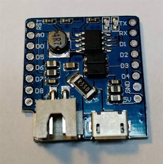

The starting point for my second attempt is a Wemos D1  Battery shield, to which I soldered 8 pin female headers with long pins so it would plug directly into the Wemos D1 mini (the photograph shows the Battery shield without the headers)

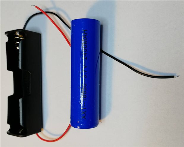

I also purchased an 18650 2400mAh 3.7V Li-ion battery and battery holder which comes with bare ended  wires:
The Battery shield has 2 connectors - a micro USB, for charging and a  XH2-2.54mm shrouded male to connect the LI-ion battery. I didn't have a mating connector for the battery so  I made up a little strip-board circuit, consisting of a (reclaimed) 2-way screw terminal block and a 3-way female header (the outer pins of the header line up with the 2 ways of the screw terminal block. The 2 wires from the battery holder are connected into the 2-way screw terminal block. To avoid the risk of a short circuit, I put 2 layers of insulating tape on the copper side of the strip-board. I also made up a short cable to connect the female header to the XH2-2.54mm connector on the Battery shield:
Before I made the decision to try the Wemos D1 battery shield, I'd looked at a number of videos and articles on the web. This excellent account of the battery shield is worth mentioning:  https://arduinodiy.wordpress.com/2016/12/25/monitoring-lipo-battery-voltage-with-wemos-d1-minibattery-shield-and-thingspeak/
I learned a number of important things from this article, including how easy it is to monitor the battery voltage. The ESP8266 A/D converter is fed from the Wemos pin A0, via a voltage divider consisting of a 220k resistor between the Wemos Pin A0 and the A/D pin of the ESP8266, and a 100k resistor from the A/D pin to GND.
The A/D converter has a maximum input voltage of 1.0V, giving a value of 1023, when read in a sketch. The presence of the voltage divider therefore allows a maximum voltage of 3.2V to be applied to to pin A0:
           1.0V =  3.2V x 100 / ( 100 + 220 )
The above article then shows how connecting a 100k resistor between A0 and the + side of the battery connector  will allow  a maximum of 4.2 volts to be monitored:
          1.0V = 4.2V x 100 / ( 100 + 100 + 220)   This is ideal because the expected fully charged state of the 18650 battery is 4.2V.

The Wemos D1 battery shield includes 2 LEDs next to the Tx pin - a red one which is illuminated whilst the battery is charging and a blue one which is illuminated when the battery is fully charged. After charging the battery for about 1 hour. my DMM showed  the battery voltage to be around 3.8V

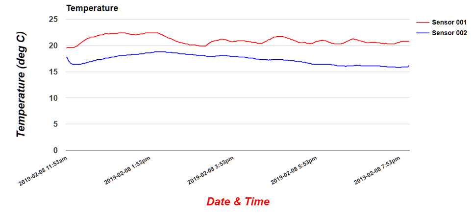

Here are the temperature readings for the same period, again at 1 minute intervals - Sensor 001 is hanging over my desk and Sensor 002 is on the windowsill, next to a double-glazed window.
The above charts are based on Nico's original code and are totally reliant on the APIs provided by Google: https://developers.google.com/chart/interactive/docs/quick_start

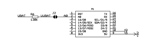

The fully charged voltage of the 18650 LI-ion battery is supposed to be around 4.2V.  My DMM is quite inexpensive and probably a biy lacking in accuracy, but the fact that the fully charged LED never came on suggests that perhaps my DMM isn't the issue here! I reconnected everything and ran the system again for a few hours. I got an almost identical discharge pattern. I repeated the charging process and once again, after 2.5 hours the battery reached 4.08V. After a further 2 hours, it was only 4.09. I suspect that this is fully charged for my battery!
I was slightly concerned by the open circuit voltage of the battery charger - 4.3V.  It's possible to imagine a situation in which that voltage could be applied to A0, thus delivering more than 1.0V to the A/D input of the ESP8266 chip. I don't know whether such an overvoltage would damage the ESP8266. However, the clever people at Wemos have recognised this and in a later version of the shield(1.3), which I don't have, they have included a 130k resistor which can be connect between the battery positive and A0, with a jumper (actually 2 solder pads).
Taken from the v1.3 schematic:
This allows for a maximum of 4.5V to be applied to pin A0, without exceeding the 1.0V limit on the A/D pin. Unfortunately, I didn't have a 130k resistor, so I used a 120k instead, thus allowing me a maximum of 4.4V. I hope that will be sufficient margin.

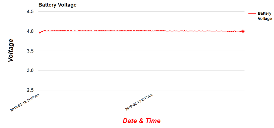

Here is a graph of the first 4 hours with a 1 minute Deep Sleep interval::
The last reading is at 4:10 pm. As can be seen, the battery voltage has barely dropped over a 4 hour period. During that 4 hour period, temperature and battery voltage readings were taken at 1 minute intervals.
