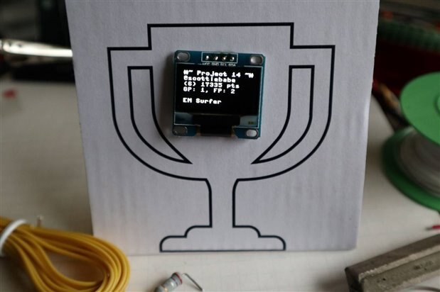

So, I as thank you, I put together a quick and simple IOT Project 14 trophy!
IOT Trophy

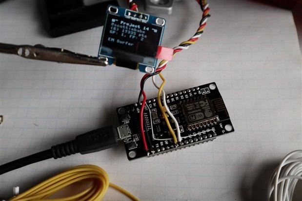

Currently the IOT is a very simple build consisting of:
- ESP8266 NodeMCU V3
- MicroPython
- SSD1306 I2C monochrome OLED 128x64 pixel display

There is lots that could be improved here, but its enough to say thanks image
from machine import Pin, I2C
import ssd1306
import socket
import ssl
import re
i2c = I2C(scl=Pin(14), sda=Pin(12), freq=100000)
display = ssd1306.SSD1306_I2C(128, 64, i2c)
rep = {'points' : 0, 'level' : 0, 'GrandPrize' : 0, 'FirstPrize' : 0 }
url = 'http://2n3904blog.com/element14/'
_, _, host, path = url.split('/', 3)
addr = socket.getaddrinfo(host, 80)[0][-1]
s = socket.socket()
s.connect(addr)
s.send(bytes('GET /%s HTTP/1.0\r\nHost: %s\r\n\r\n' % (path, host), 'utf8'))
while True:
    dat = s.read(2048)
    if dat:
        idx = dat.find(b'scottie')
        if idx >= 0:
            print('Found Scottie @ index: {}'.format(idx))
            m = re.search('<p>Points: <strong>([0-9]+)</strong></p>',dat)
            rep['points'] = int(m.group(1))
            m = re.search('<p>Level: ([0-9]+)</p>',dat)
            rep['level'] = int(m.group(1))
            m = re.search('<p>GP: ([0-9]+)</p>',dat)
            rep['GrandPrize'] = int(m.group(1))
            m = re.search('<p>FP: ([0-9]+)</p>',dat)
            rep['FirstPrize'] = int(m.group(1))
    else:
        break
s.close()
display.text('#~ Project 14 ~#', 0, 0, 1)
display.text('@scottiebabe', 0, 10, 1)
display.text('({}) {} pts'.format(rep['level'],rep['points']), 0, 20, 1)
display.text('GP: {}, FP: {} '.format(rep['GrandPrize'], rep['FirstPrize']), 0, 30, 1)
display.text('EM Surfer', 0, 50, 1)
display.show()
There are definitely still some refinements to be made in the future. I need to determine how to load ssl certificates into uPython, as only a few webservers seem to be supported presently. A low power display is a absolute must for long-term battery powered operation. And, of course, a nicer mechanical build, perhaps a 3-D printed trophy with a display mount.
