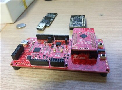

First impressions
The packaging is very well made - electronics are protected and it is suitable for continuous usage. The kit contains:
1  CY5671CY5671 PRoC BLE module
2  CY8CKIT-142CY8CKIT-142 PSOC 4 BLE module
3. BLE dongle for PC
4. Baseboard with a holder for PSoC 4 BLE or PRoC BLE modules
5. Jumper wires
6. Proximity wires - for CapSense technology demonstration
7. Coin cell
8. USB mini cable.
One of the things that I really like about the baseboard are the rubber 'legs' on the bottom side. It proved really useful to me because not only it protects the bottom pins from accidentally touching something on the table, it also sort of sticks to the table so it's more difficult to drag it.
I really liked the fact that USB mini cable, coin cell, the wires and PC BLE dongle are included. It proved useful to me, but maybe because I have a shortage of this stuff image
The kit is preloaded with project example: by plugging the BLE dongle to the PC and putting the coin cell in the baseboard you can control the LED intensity on BLE dongle by sliding the finger on the slider.
About the PSoC BLE kit:
The main component of it is of course  CY8CKIT-142CY8CKIT-142 PSoC 4 BLE module. It has a Cortex M0 based chip with programable analog and digital peripherals, CapSense module for touch sensing and BLE radio. There is also an antenna on the module itself.
PRoC  BLE module is similar to PSoC 4 BLE module while lacking some functions like CapSense. I have not yet looked into it deeply.
The baseboard has programmer/debugger, arduino compatible headers, coin cell battery holder, Capsense slider, user and reset buttons and etc..
PC ble dongle gives BLE compatibility for the PC. There is also a software package to check bluetooth received/sent packets.
