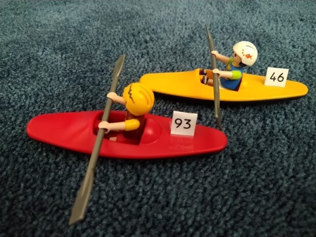

A friend of mine races kayaks and apparently the monitoring of kayaks crossing the finish like is manual and fraught with error. There are lots of "recounts" and nobody trusts the results at all. I decided to identify the numbers on the kayaks as they cross the finish line, so I started digging into OCR (Optical Character Recognition).
As nobody is racing kayaks at the moment I decided to make use of the slightly odd blue carpet that was fitted when we bought the house and fake it a bit. I have some video, but to start with I decided to use this image. I made the numbers reasonably easy to read and even used an OCR-B font. OCR-A will probably look reasonably familiar but is a bit too strange to convince anyone to use for racing!image
All image processing of this type like nice clean data to work with and so I grayscaled the data, used a threshold so I was just looking at black and white and applied a Gaussian blur to smooth any noise. All fairly standard stuff.
I also found that a "tophat" morphological operator removes the large elements, leaving just the smaller detail that we're interested in. So far so good. Here's a sample of the Python in my notebook:

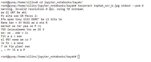

Tesseract OCR
If you Google OpenCV OCR to tend to find that you're led towards Tesseract and (for Python) PyTesseract. You simple point Tesseract at your image and tell it where to put the text output. There are of course a few options, which I tweaked to tell it that I was looking for separate pieces fo text rather than a whole page. The output was pretty awful and also took about 10 seconds on the Pynq Z2. I managed to get something if I gave it the cleanest screenshot of some on-screen text but it was still pretty bad.
i decided that considering how slow it was, it wasn't worth pursuing much further. Time to look at a different approach.
